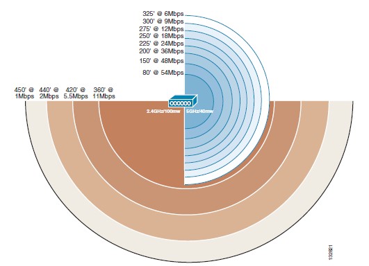

4.Using 2.4 GHz , on 20 MHz is OK. Do you really need the very old 802.11b? That 1 Mbps rate stretches very far ! Giving a lot of overlap.
