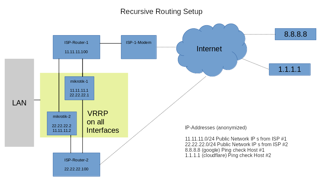

I have a similar problem like here:
Disconnected WAN port causes Failover to not work
My Setup has some differences:
  • I’m using bonding for both ISP-Routers.
  • ISP-Routers and Mikrotiks are not directly connected but with intermediate Switches on separate VLAN.
Here’s the schematics of my setup:
This is my mikrotik-config:

The failover works fine, if I put a firewall rule in place to block all traffic outbound at interface bond_isp1 or just to the ping hosts 1.1.1.1 / 8.8.8.8.
The failover does not work, when I just plug out the cable from the Modem of ISP #1 (ISP-Router still reachable via ping).
As far as I understood, the problem in the linked thread is, that the interface goes down and the recursive no longer works. But I assume this is not the case here, because the of the intermediate switches. Am I wrong?
Any hint what could be the problem here?
