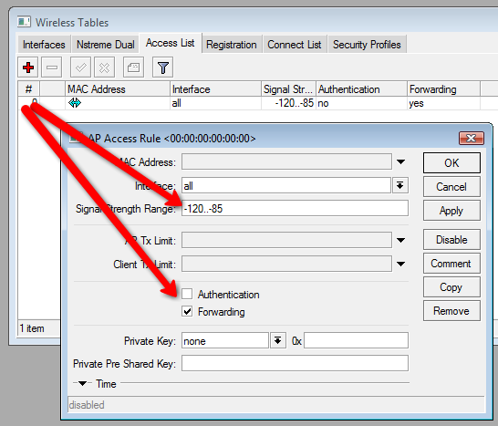

can’t you do that already with access list ???
The script works differently than that rule.
The user with bad signal experience something like this:
5 minutes of blocking the wireless with deny packet, then 5 minutes of working wireless.
You can always see in the access list the clients that have been rejected becouse of the bad signal.
