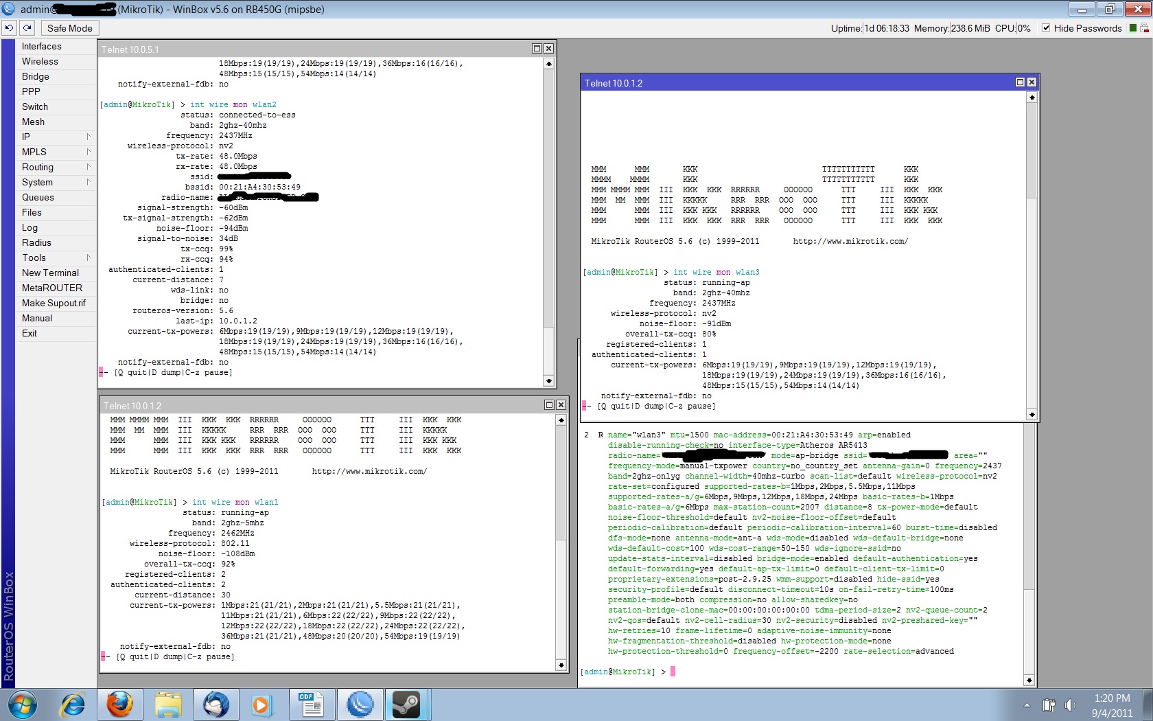

I have a backhaul link that has a disconnection problem. First, I will illustrate this for you. We basically have a link like this.
Tower A >>>> Tower B > Sector.
The link is using the atheros ar5413 cards with 2.4 turbo, and the sector is also on 2.4 ghz using the r52hn cards. The signal strengths are very good, but the problem happens when the customers on the sector pull any amount of traffic over 1 meg. When this happens, the ccq on the backhaul link drops to 0 and the link fails after a few seconds. This seems to happen even if we use smaller channels and separate them as far apart as possible.
If anyone would be willing to give me some insight it would be deeply appreciated! We have very unhappy customers :frowning:

Another idea I have is it could possibly be a power issue. We had to upgrade the PoE once because the routerboard would shut off when we enabled all three interfaces. (There is also a 5 ghz grid on tower b feeding to another tower). It’s about a 130 ft run of cat5 up to the router.
