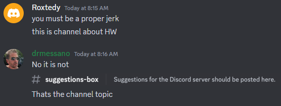

I wrote question about power adapter for RB960PGS in channel suggestion-box and he advice me to ask in firewall topic, then I asked about explanation and he deleted all what I wrote and gave me ban for 24 hours.
Please hire normal people. I though he is AI robot who do not understand what he adviced.
Asking in the wrong place seems to be your talent :smiley:
we will ask the moderator to be more polite, but FORUM is not a place to complain about random discord moderators. They are not hired, discord is not a mikrotik support channel. Moderators are just random community people.
To be fair, you asked in the wrong chat there. Suggestion box is not the right chat channel for router questions.
he named me jerk first. Ok, so help me please where can I ask question about adapter for RB960PGS? Can I use the original adapter to power 5x 802.3af/at ? Or I must use stronger adapter?
