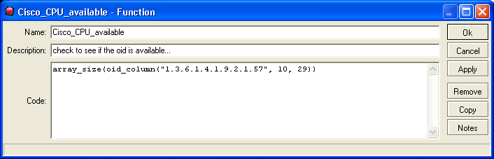

Or create a function for the available field that checks to see if OID exists.
Function name “Cisco_CPU_Available”
Function: array_size(oid_column(“1.3.6.1.4.1.9.2.1.57”, 10, 29))
Available: Cisco_CPU_Available()

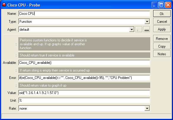

Error if x, “”, “error”
value: oid(“1.3.6.1.4.1.9.2.1.57.0”) Notice that I am graphing the value but In the Available line I am checking to see if the OID exists not the value that would be returned.
So I think that Available is not able to read the “Value” but is able to check that the OID is actually there, sounds like that is what it is supposed to do, BUT is it a bug that if you specify the “OID.Value” on the Available line it always returns as true.
Anyhow I have had situations that I could not get things to graph correctly until I used a function for the available line. Maybe I didn’t know clearly what was going on or I did something differently or just was confused and built my probe wrong. ![]()

Here is a couple screen shots of the cisco cpu function and probe that I use for a model for all my other probes.
That might clear things up a little bit.
