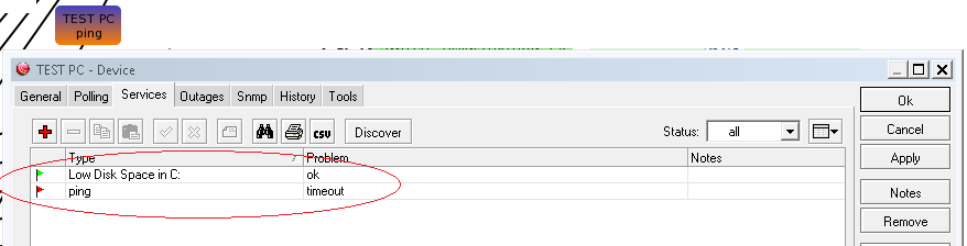

Disk Probe Status alway shows OK even device is down
I have setup disk probe to monitor C: drive space on all servers, the problem is that even if all the servers are down, the disk probe status always shows ok therefore device color doesn’t change to RED, it remains orange. Why disk probe is showing OK even the device is down.
How to overcome this issue ?

It is most likely to do with the logic of your probe Error statement. If the device is down then the OID query will not be able to retrieve any value - this will be evaluated as a 0 and may end up making your error statement come out as a TRUE. I always write my probes with an if inside an if statement. The outer if statement checks if the device is contactable and the inner if statement does the error check. There a are others that guard against timeouts by adding +1 to numeric values and then subtracting it later on.

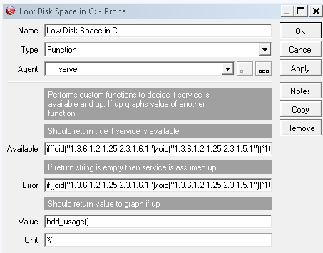

my probe is as below . . .
Name: Low Disk Space in C:
Type : Function
Available:
if((oid("1.3.6.1.2.1.25.2.3.1.6.1")/oid("1.3.6.1.2.1.25.2.3.1.5.1"))*100>0, 1, -1)
Error:
if((oid("1.3.6.1.2.1.25.2.3.1.6.1")/oid("1.3.6.1.2.1.25.2.3.1.5.1"))*100<85, "", concatenate("Disk C:  Used space is currently at (", string_substring (oid("1.3.6.1.2.1.25.2.3.1.6.1")/oid("1.3.6.1.2.1.25.2.3.1.5.1"))*100 , ") % "))
Value:
hdd_usage()
Unit: %
[edit - as geoffsmith31 already said an if inside an if gets you clearer results]

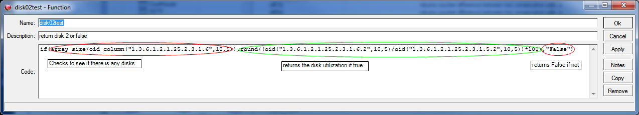

I like to use a function then call the function from the probe. This way you can determine if the device is down or if the device is in error.
Make a function called disk01test
if(array_size(oid_column(“1.3.6.1.2.1.25.2.3.1.6”,10,5)),round((oid(“1.3.6.1.2.1.25.2.3.1.6.1”,10,5)/oid(“1.3.6.1.2.1.25.2.3.1.5.1”,10,5))*100),“False”)
Repeat the above for as many disks as you have, incrementing the names and oid values by one. Note Drive C is normally disk02.
disk02test
if(array_size(oid_column(“1.3.6.1.2.1.25.2.3.1.6”,10,5)),round((oid(“1.3.6.1.2.1.25.2.3.1.6.2”,10,5)/oid(“1.3.6.1.2.1.25.2.3.1.5.2”,10,5))*100),“False”)

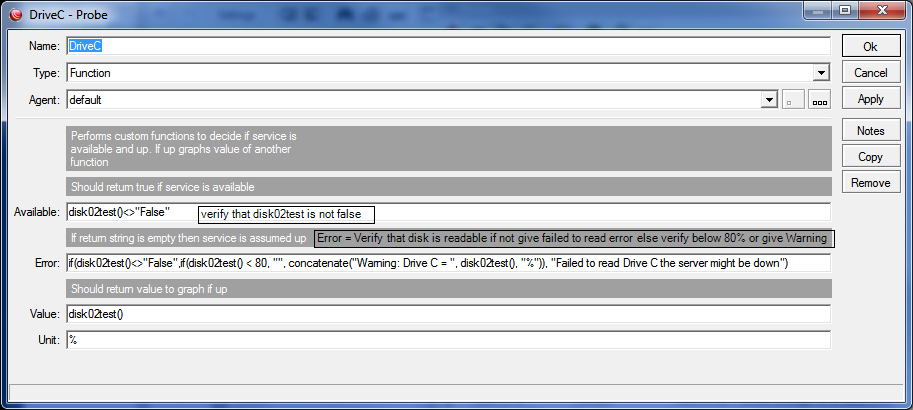

Create a probe DriveC
Available disk02test()<>“False”
Error if(disk02test()<>“False”,if(disk02test() < 80, “”, concatenate("Warning: Drive C = ", disk02test(), “%”)), “Failed to read Drive C the server might be down”)
Value disk02test()
Unit %
lebowski you are Legend of DUDE :sunglasses:
Thank you it worked perfectly.
