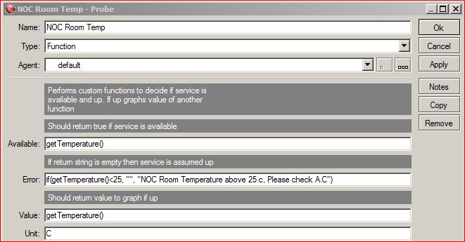

Now i have a probe which should warn me if temperature goes above but how can I insert DIVIDE value
PROBE:
Name: NOC Room Temperature Over
Type: Function
Available: if(oid("1.3.6.1.4.1.13400.2.62.2.1.2.0")0, 1, -1)
Error: if(oid("1.3.6.1.4.1.13400.2.62.2.1.2.0")<25, "", "NOC Room Temperature above 25 c,  Please check A.C")
Value: 1.3.6.1.4.1.13400.2.62.2.1.2.0
Unit: C
( If I enter value 2500, it give me error of not available)

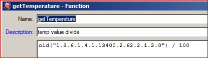

Create a function which will read and divide the temperature:
Code: oid(“1.3.6.1.4.1.13400.2.62.2.1.2.0”) / 100
Use that function in the probe:
Value: getTemperature()
I created FUNCTION as you suggested, but still I am not getting DIVIDED value. see the snap of my Function & PROBE.

yes i m getting value in appearance using the FUNCTION. but unabel to get DIVIDED value in the FUNCTION/PROBE :frowning:
If the function returns correctly in the label, it has to return correctly in the Probe as well.
Check if you have multiple Probes, check if you are using the right Probe, check if you didnt accidentaly click Cancel when saving the Probe etc.
It really should work, lets check if its not something simple first :slight_smile:
Your error line on your probe shoould be;
if(getTemperature()<25, “”, “NOC Room Temperature above 25 c, Please check A.C”)

Finally got it. I think I had to add “getTemperature()” in AVAILABLE section too. attached is image of working config.
