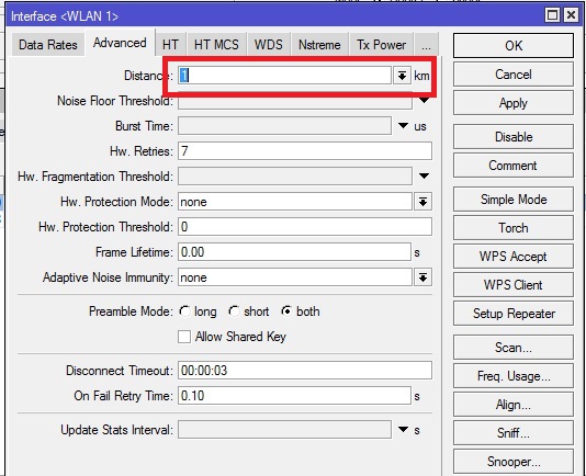

Friends. I am completely new in the configuration of mikrotik equipment wirelessly, how do I set 300 meters or 0.3 km, which is the distance from the AP to my station?

The screenshot is not from 6.49.7…
Leave it dynamic, so it does the correct calculation automatically.
The unit is kilometers, so for 0,3Km it is 1, because it is not possible to enter floating point values…
1Km = 4.33µs
(0Km = ~1µs but your device is not fast and close enough for reply…)
What do you expect by changing it???..
This parameter is for kilometer connections,
There is nothing to do with for distances of less than a kilometre…

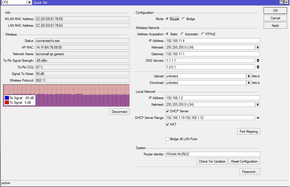

This is my station
What power should I put on my equipment?

-65 ??
do not touch any… (the router identity is visible…)

The quick setup menu can only be used once, after that it is not recommended to change the settings through it.
More informative tab Winbox/Wirelless/Registration double click on the desired line and in the menu that opens tab Signal
