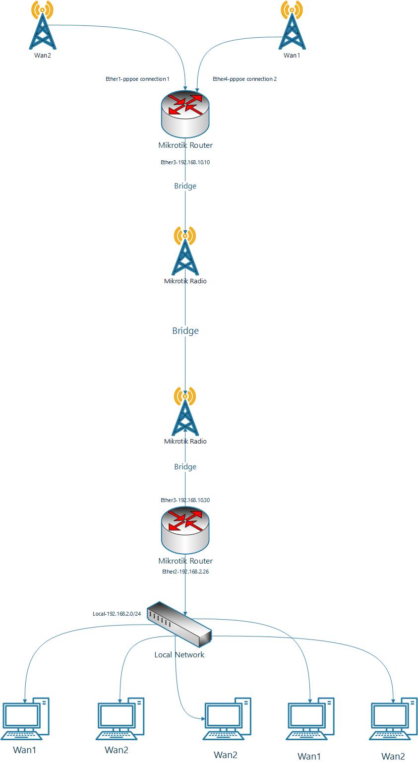

hi. i need distribute my two different internet in my local network as i showed in pdf file. can anyone help me to solve my problem. i appreciate your help.
Plan.pdf (121 KB)
If all the Mikrotik devices on the picture are under your control, you can use two VLANs to host two intermediate IP subnets on the link between the two routers, or you can even run the PPPoE clients on the bottom router if you use two VLANs to bridge the PPPoE frames between the two routers.
all of them are under my control. i tried to use vlan but I did not succeed please show me what can i do with detail . thank you.
To do so, I need exports of the current configurations of both routers and the radios (as they may theoretically be blocking VLAN traffic). My automatic signature right below suggests how to do that and how to anonymise the sensitive contents of the exports which is not removed by the hide-sensitive parameter.
And your preference (PPPoE clients to run on the upper device or on the lower device) - the models of the routers are important for the actual choice, though. If they have similar CPUs, it may even make sense to let each run a single PPPoE client and firewall to spread the CPU-intensive tasks among them. If you plan to use things like failover or load distribution (same LAN host using two WANs), it is also worth mentioning, as well as eventual traffic shaping.
unfortunately i don’t have access to bridged radio but i send you the upper mikrotik and bottom mikrotik config that showed in the picture .the model of router is specified in the config. thank you

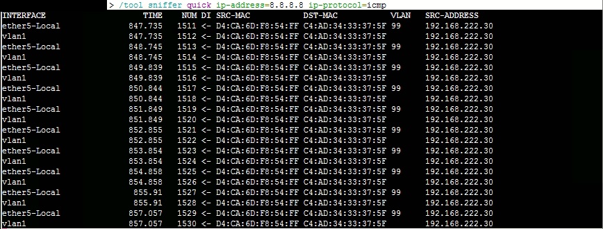

So to quickly check the VLAN transparency of the wireless path, do the following:
- on the hEX:
/ip address add address=192.168.222.10/24 interface=vlan1 - on the 2011:
/interface vlan add name=vlan1 interface=ether3 vlan-id=99
/ip address add address=192.168.222.30/24 interface=vlan1
:ping 192.168.222.10
If you get ping responses, the bridge is VLAN-transparent, and we may move further. If the bridge is not VLAN-transparent, it is still possible to do some ugly tricks to distinguish the traffic on the bridge so that you could control which WAN will be used for what using policy routing at the 2011.
And if you cannot see the ping responses, use /tool sniffer quick interface=ether3 at the 2011, and /tool sniffer quick interface=ether5 at the hEX while pinging, to see whether the frames tagged with VID 99 do not leave the 2011 (which would be a configuration mistake) or do not arrive to the hEX (which would mean that the wireless link is not VLAN-transparent).

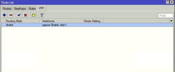

On the hEX, add a VRF setup for Shatel: /ip route vrf add routing-mark=shatel interfaces=pppoe-Shatel,vlan1

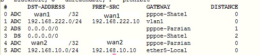

thanks. after your guide i can add route to vlan1(192.168.222.10) but i cant ping 8.8.8.8 through that in 2011

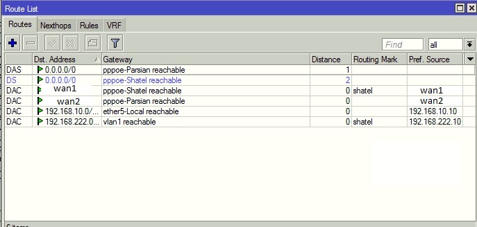

You can’t add both routes to the same routing table (i.e. give them the same routing-mark, none in this case, which is equal to explicitly stating main) with the same distance and expect that by indicating the interface for :ping, the proper route matching that interface will be chosen. RouterOS does not work this way.
So set routing-mark=via-Shatel to the route with gateway=192.168.222.10, and then do :ping 8.8.8.8 routing-table=via-Shatel. That way it should work.
If it does not work, you’ll have to make the command line window for the hEX as wide as your screen allows, run /tool sniffer quick ip-address=8.8.8.8 ip-protocol=icmp there, and run the :ping command as above at the 2011. It should show you the path of the packets through the hEX.
i did this but still get timeout

and i did this too .and this is the result:
So the packets do arrive to the hEX but don’t get further (even the requests don’t). What does /ip route print detail show at the hEX?
Hm, great, so there is a bug in the VRF handling of PPPoE interfaces… the default route is not being added with the proper routing-mark.

So you will need to work this around using the following:
/ppp profile add copy-from=default on-up=“/ip route add gateway=$interface routing-mark=shatel” on-down=“/ip route remove [find dst-address=0.0.0.0/0 routing-mark=shatel]” name=pppoe-vrf
/interface pppoe-client set pppoe-Shatel profile=pppoe-vrf add-default-route=noAfter that, try the ping test again.

In a very simplified view, the /interface pppoe-client is a translator between an L2 interface (addressed by MAC) and the L3 (addressed by IP). The L3 end of this translator cannot be bridged with anything.
The IP address is assigned to the /interface pppoe-client by the remote PPPoE server. So there is no simpler way how to use the VLANs to let the 2011 choose the WAN than the one I’ve suggested if the two /interface pppoe-client stay at the hEX. Use of VRF was the simplest one available, the bug has made the setup more complex, its appearance was a surprise for me. But even with the workaround for the bug, it is the simplest way for the L3 approach (one interconnection L3 subnet per WAN between the two devices).
Instead, you could extend the L2 part of the path from the hEX to the 2011 by bridging each ISP-facing interface of the hEX into one VLAN and running the /interface pppoe-client on the 2011, but it won’t make things much simpler, plus it would put all the load to the 2011 - the processing of PPPoE also takes some CPU. The switch chip on hEX does not support VLAN tagging/untagging in hardware, so you’d have to use a bridge-with-vlans configuration on both the hEX and the 2011
2011:
/interface vlan add name=vlan0 vlan-id=77 interface=ether3
/interface pppoe-client add name=pppoe-Parsian interface=vlan0 user= …
/interface pppoe-client add name=pppoe-Shatel interface=vlan1 user= …
/ip address remove [find interface~“vlan1”]
hEX:
/interface pppoe remove [find]
/interface bridge add br-pppoe vlan-filtering=yes
/interface bridge vlan add vlan-ids=77,99 tagged=ether5-Local
/interface bridge port add bridge=br-pppoe interface=ether1-Parsian pvid=77
/interface bridge port add bridge=br-pppoe interface=ether4-Shatel pvid=99
/interface bridge port add bridge=br-pppoe interface=ether5-Local
/ip address set [find interface~“ether5”] interface=br-pppoe
This way, you would have the L3 WAN interfaces directly on the 2011, but the only positives I can see here is easier port forwarding, the rest are the negatives mentioned above plus possible complications if using the scriptless failover between the WAN based on recursive next-hop search.
