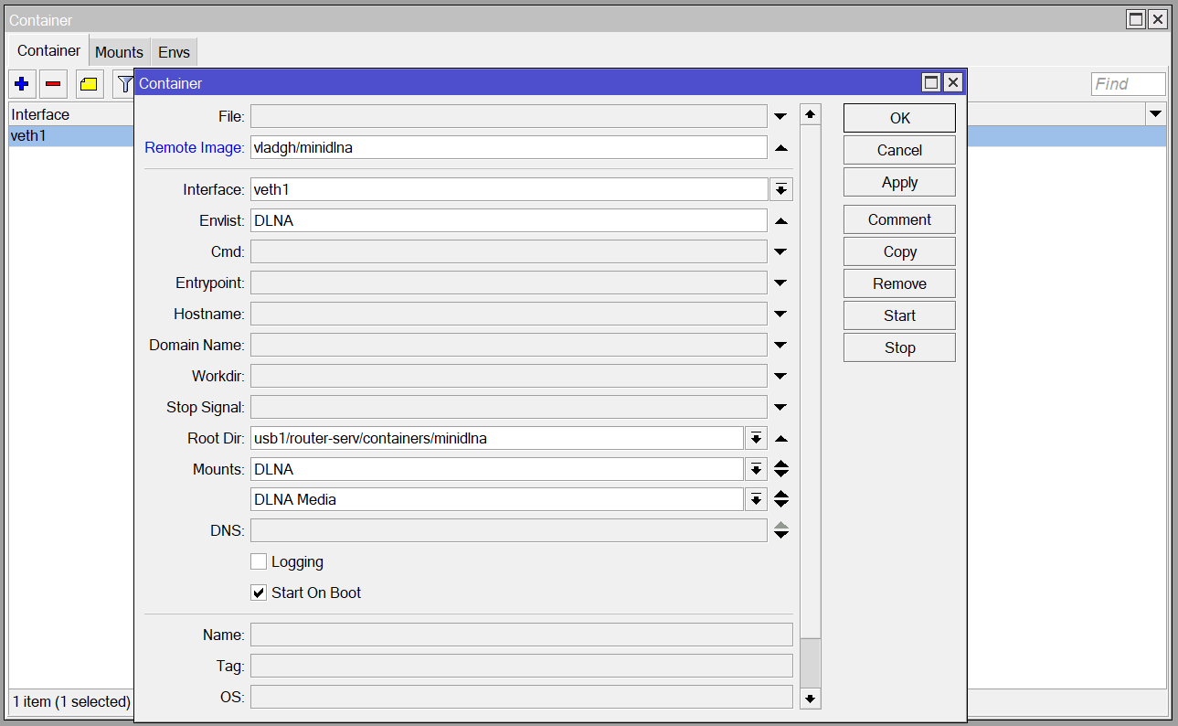

Sure, if you look at “tags” and something has “linux/arm/v6”, it should work – yes, assuming an external disk (or potentially ROSE).
You should be able to follow the Pi-Hole example in the docs EXCEPT…
  • just use “vladgh/minidlna” as remote image.
  • for the “mounts” use:
    /media to your RouterOS disk path
  • for env variables add:
    MINIDLNA_MEDIA_DIR /media
    MINIDLNA_FRIENDLY_NAME=MikrotikMiniDLNA
  • for the networking, skip adding the “docker” bridge, instead just add the created VETH to the existing LAN bridge
  • when creating the VETH for minidlna… use an unused IP address from your LAN (e.g. 192.168.88.8/24 and 192.168.88.1 as VETH gateway if your using default LAN), and use the Mikrotik’s LAN IP address as the gateway

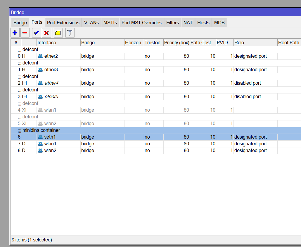

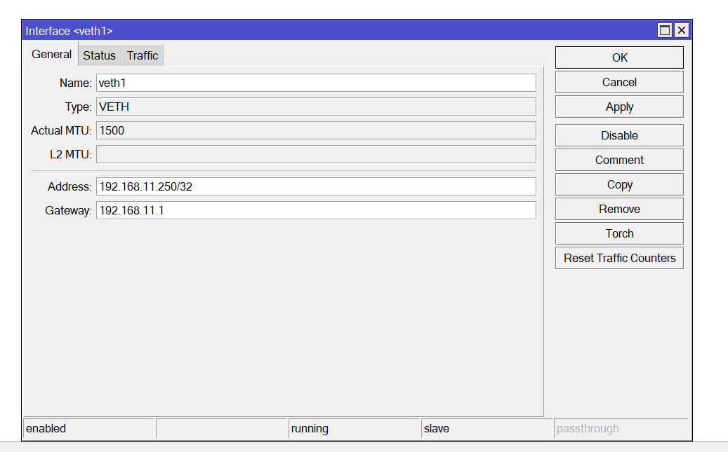

I create a new VETH interface with a new IP address of my LAN
Please note that I use 192.168.11.0/24 and not 192.168.88.0/24, so change the IP address according to your LAN
I added veth1 to the main bridge

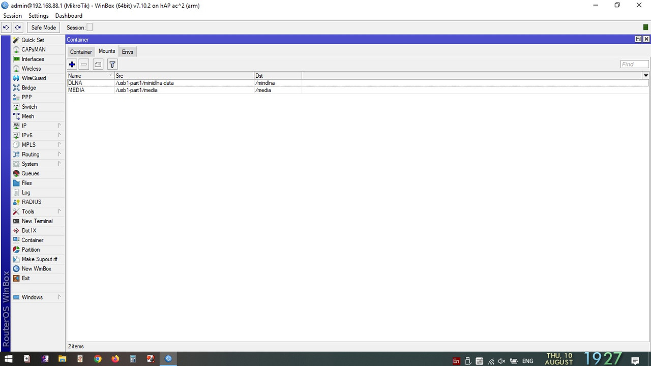

I inserted a usb hdd and formatted it in ext4 with no partitions.
I can’t stand clutter so I created a folder for containers, one for container data and one for media.
I shared only the media folder with smb so everyone can add movies but no one can edit the container files.

Hi, I specified that the files inside the container shouldn’t be modified.
one folder for container data and one folder for media.
You don’t need to change permissions, don’t put the movie folder inside the container folder.
Yes, I made a mistake on this point. Thank you. Now it works great.

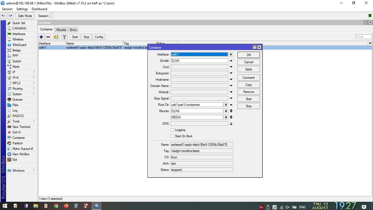

Help to configure. The server starts and immediately stop.
Check the “Logging” box, then try to start it. The log should have some clues on what’s going on.
Also post the results from a “:export” at the terminal if you can.
Log noted.Where can I watch it?

Well “Log” on left in winbox… or but from New Terminal easier to cut-and-paste here :wink:
/log print where topics~“container”
You have a typo on the VETH gateway…
/interface veth
add address=192.168.88.11/24 gateway=192.169.88.1 name=veth1
That should be “192.168.88.1” not 192.169…

deleted veth1 в /ip upnp
changed 192.168.88.1
Can you hit “Start” in on the container, then grab the log?
Does not display. Does it come out and does not start?

Hmm. I was kinda expecting it to start after fixing the gateway. And the logs don’t show anything, which is kinda strange since normally there be some error in logs AFTER hitting start…
I’ve seen containers be picky about changes in the VETH’sgateway… Maybe try deleting the VETH, and re-create it again with same/correct IP information, then re-assign the new VETH in the container. Then try to start again…
