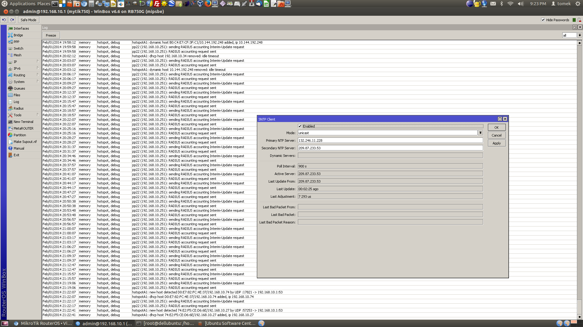

First, insure you have NTP client set up on the router. Without the correct time, some of these radius functions don’t work.

Do you have NTP set up in the router? My system sends a radius response of access-accept with the current date and time when the client enters the info in the RADIUS database.
Like now, if the client tries to login with the user and password in the database, it would send an access-accept with WISPr-Session-Terminate-Time = 2014-02-01T10:02:00. If your NTP is working, the time in the router now (a few seconds later) is 2014-02-01T10:02:10. It would not let you login, not because the it received access-reject, but the WISPr-Session-Terminate-Time has passed.
If you do not have NTP set correctly, the date/time in the router would be 1970-01-01T01:00:00. You could login for the next 44 years.

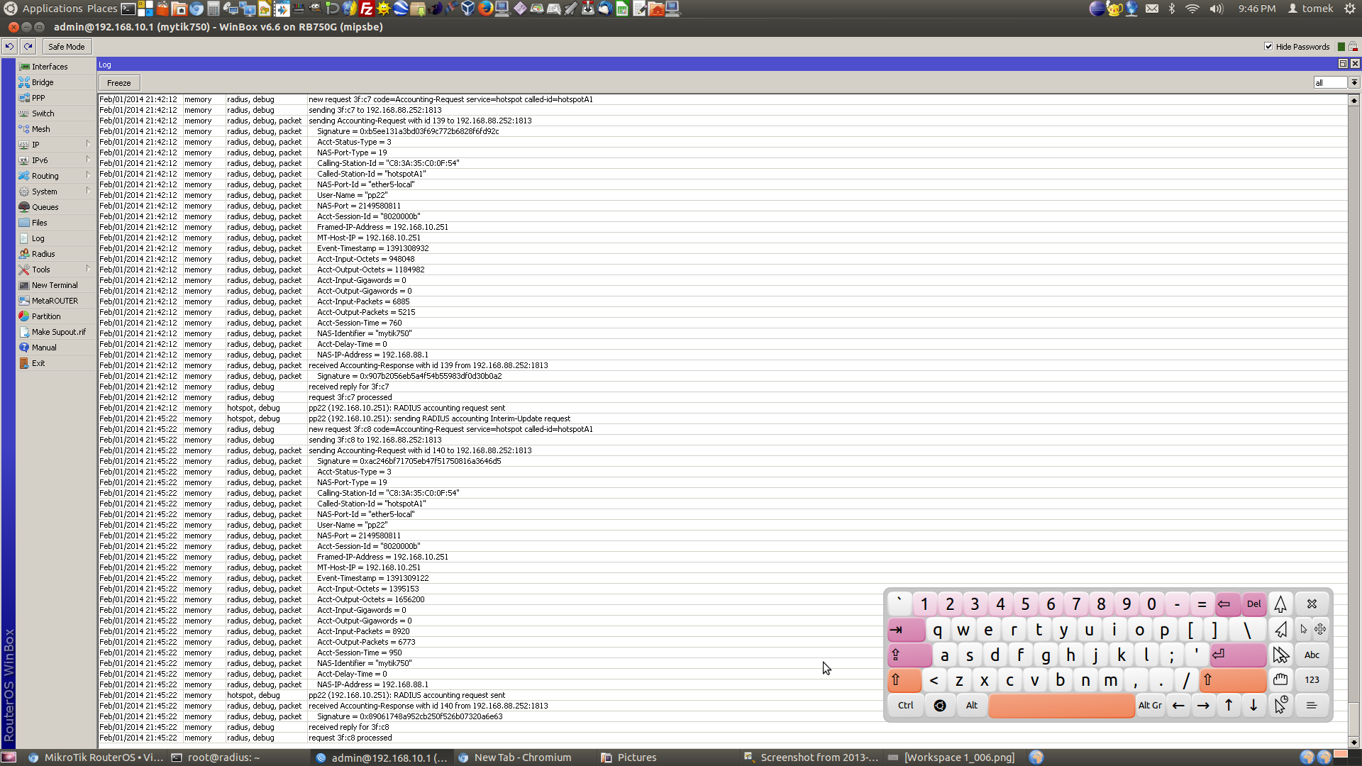

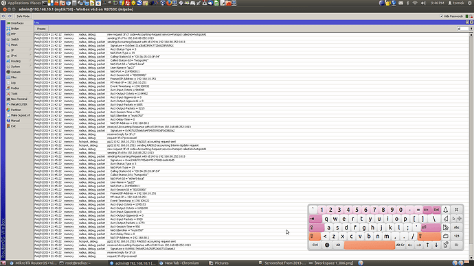

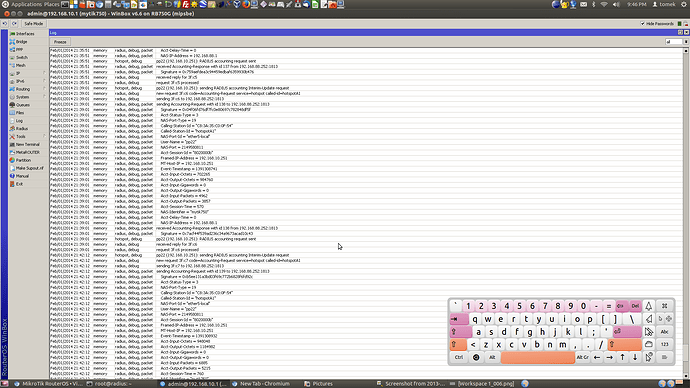

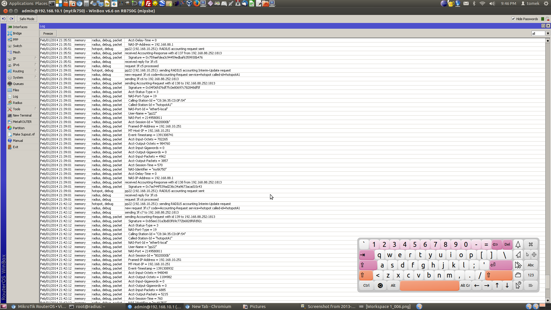

Hi

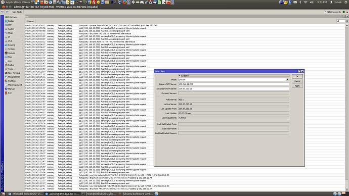

Thanks for you info. But I dont see those entries like you mentioned in my RADIUS log file on my mikrotik router. Time (SNTP ) on the mikrotik router are set up appropriated and are ok on the Radius too.
RADIUS ssh welcome msg:
Welcome to Ubuntu!
System information as of Sat Feb 1 21:39:41 EST 2014
System load: 0.0 Processes: 228
Usage of /: 80.7% of 33.64GB Users logged in: 1
Memory usage: 44% IP address for eth0: 192.168.88.252
Swap usage: 4%
I dont see WISPr-Session-Terminate-Time in my log so i dont know what that is. New users still self-register them self without paying, and they use internet for free.
Those are all accounting requests, not access requests. Here is my radius access-request. I set the access-request in bold, along with the WISPr-Session-Terminate-Time.

None of those log sections show where you logged in (Access-Request), only the accounting after you logged in (Interim-Update).
They are all sent to port 1813. That is the accounting port. The auth port is 1812.
edit: If your username is not a “paying customer” type, it may not send a WISPr-Session-Terminate-Time with your Access-Accept.
I have a “managers” type user that can login forever, and that is not sent with their Access-Accept.
Only paying customers get that.

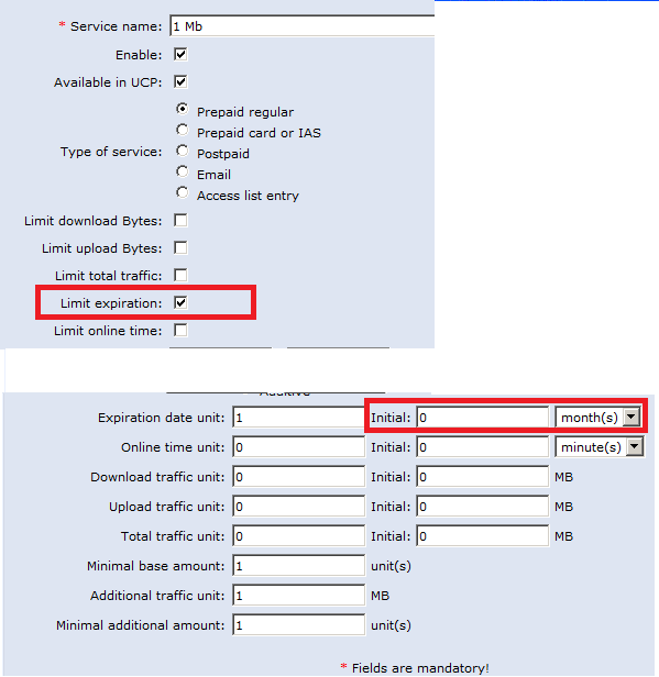

Open you Radius Manager ACP, Goto Services, and make sure in all services properties, Initial balance is set to 0.
As showed int the image below …
This way when the user will self register, his initial balance will be Zeo, so he will not be able to use the internet, he can only open the User Panel from where he can refresh his User ID using your provided refill card, if you are providing with scratch card system, or you can manually refill his account upon user request.
