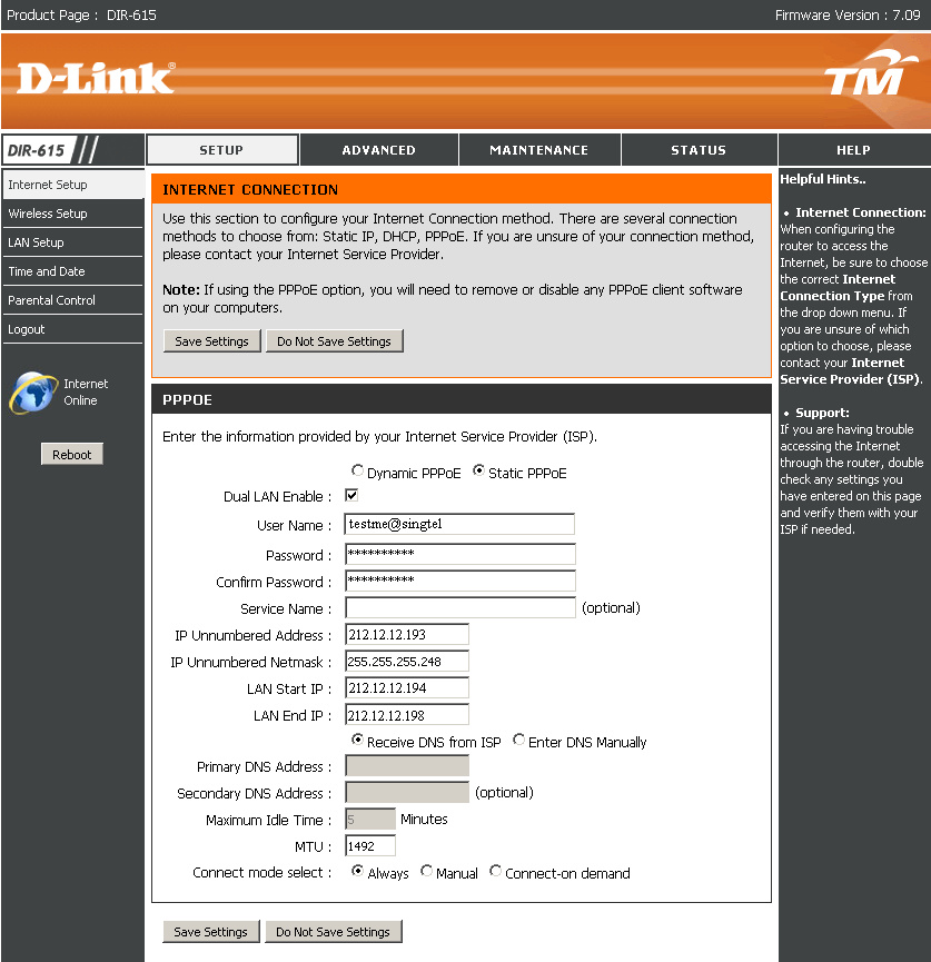

The Dlink615 we are using right now provide this bridging feature (using IP unnumbered) between WAN and LAN interface (PPPOE). I wonder if this is supported too in RouterOS?
See pic attached below.
You can achieve something similar. How do you use the existing service? Network layout?
It’s quite a simple layout. Once all LAN port bridge to WAN, all these devices on LAN port use public IP (such as my firewall). There is risk doing this way but I just do not want another device doing routing/NAT overhead that slow things down.

I have PPPOE client (dial via VLAN500) configured and link comes up. I have /29 public IP assigned through PPPOE (static IP). Everything from PPPOE seems alright and I know I can’t bridge this PPPOE interface to the LAN. Since the PPPOE interface (VLAN500) is assigned with this public IP, is static arp my only solution?
ether1-gateway (Ethernet)
VLAN500 (PPPOE dial interface) with 212.12.12.193/29
ether2-master-local (Ethernet) - noip with static arp 00:11:22:33:44:55 map to 212.12.12.194
ether3-slave-local (Ethernet) - noip with static arp 00:11:22:33:44:66 map to 212.12.12.195
Would this work?
You can tell bridge to use the IP Firewall under Bridge /Settings or Interface / Bridge / Settings in the CLI. Note however that if you do so the system will then be looking above layer 2 so the overall efficiency will probably be somewhere between pure bridging and pure routing.
There is a simpler filtering system available under Filters within the bridge itself.
If you wanted to try a routed solution then from the D-Link config I suspect that you could just use the PPPoE interface as the default gateway, allocate the .129 address to the router and use the rest of the /29 range on a LAN interface. I suspect that the performance would be fine with a routed solution on something like the RB2011 series.
