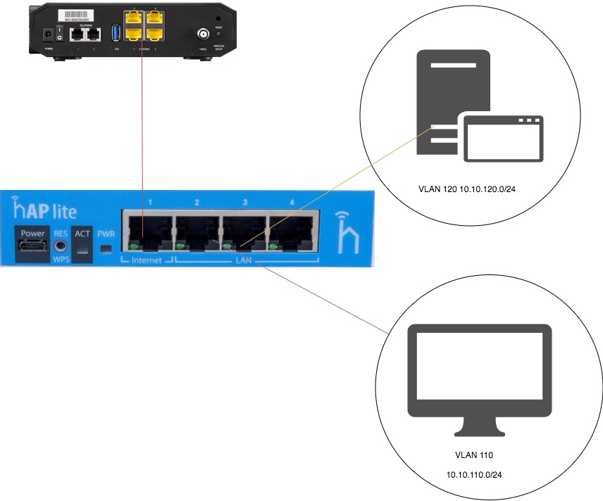

Guys,
This is not working could you explain why not ?

I’m skipping the VLAN part, because I’m not familiar enough with VLANs using hardware switch. But those default routes with gateways being addresses on the same router can’t do you any good. NAT rules are also a little strange. And some more info about 192.168.1.0/24 and the black device would probably help too.
Just to clarify 10.10.110.0/24 is a vlan for a web server the other vlan is one for the office PCs

isn’t eth1 the first port? and I guess thats your “outside world”, probably the modem?
You put the master port of your switch to eth1, I think that you should not do that (and it’s maybe the reason masquerade does not work), it should be eth2-4 and you can then bridge.
What you did is use the device as a “switch only”

Lets pretend for a while that you don’t need any VLANs and try some basics.
I guess the black modem/router probably does routing and its LAN is 192.168.1.0/24. Let say it has internal address 192.168.1.1. Then if you wanted to have two independent LANs, you’d keep ports 1-3 on RB separate, i.e. not switched or bridged together. The basic config would be:
RB:
ether1 address: 192.168.1.x/24 (where x is anything except 1)
ether2 address: 10.10.110.1/24
ether3 address: 10.10.120.1/24
default gateway: 192.168.1.1

When you add VLANs, this basic config remains the same, you only work with different interfaces. That’s unless the modem would be handling VLANs and you’d really be using RB only as managed switch. In any case, I’m not good with VLANs in hardware switch, but there are some nice examples in wiki.

Thanks for your reply. I can do this configuration using bridges like I normally do and it works fine. Unfortunately, on this setup I will need to use VLANS as they will be used to communicate to other equipment. What I need is a basic setup using VLANs
Is ether1 your WAN interface? I’ll assume from your diagram.

Let’s use the software approach as is easier and more flexible. Start by resetting the hap to no defaults (you can connect later using the neighbors tab on winbox)
Make ether3 slave of ether2; ether1 is the WAN interface so should be alone and not used as master/slave of any other interface, nor added to any bridge.
/interface ethernet set ether3 master-port=ether2
/interface vlan add name=vlan110 interface=ether2 vlan-id=110
/interface vlan add name=vlan120 interface=ether2 vlan-id=120
/ip address add address=10.10.110.1/24 interface=vlan110 network=10.10.110.0
/ip address add address=10.10.120.1/24 interface=vlan120 network=10.10.120.0
It’s all needed. The hAP will start routing between VLANs.

Thanks :slight_smile: This is much closer to what I need but ether 1 will have a DHCP client to connect to the provider’s router will the vlans be able to communicate to the internet in this way ?
