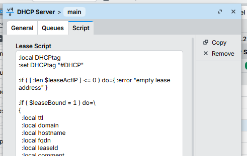

In case you haven’t yet found, there are plenty of routeros scripts floating around which will add static DNS entries for DHCP leases. E.g.:
You can add this to the DHCP server script entry:
Thanks for sharing that script as this ultimately led me to discover what i had done wrong.
I hadn’t populated the domain field for each network under IP –> DHCP Server –> Networks
After adding a search domain, it all now works as it should do.
