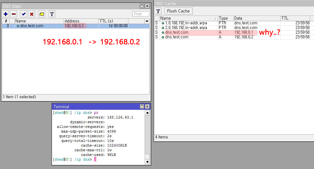

Why is there 192.168.0.1 adddress ?

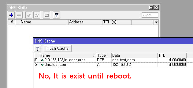

till the timeout or deleting the static DNS, the entry exist
No, It is exist until reboot.

how to reproduce it?
If not previous static DNS entry exist, add one static dns, after that change the ip on that static rule and save: done, you have get “duplicate entry”, not realy duplicate, but is work like previous static rule already exist.

Replace static IP address a few times.
hi Guys,
I have same problem on 6.12 and 6.17
It’s problem with update of DNS static records over WinBox (can’t reproduce it over terminal)
to reproduce:
  1. create new record
  2. edit ip in WinBox
  3. BOOOM - DNS server resolving two addresses
  4. edit ip in WinBox
  5. BOOOM - DNS server resolving three addresses
  6. remove DNS static rule
  7. BOOOM - only last one IP removed from result
Hope it help you and you are able to fix it quick.

need more details - on test router everythign stops at BOOOM. and static entries are updated correctly in cache every single time.
tried to create inital entry via winbox or via cli, no difference.
same…
check shed video - looks same on my site
