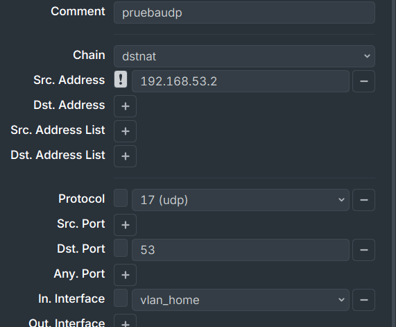

You should properly clear the src-port condition. If using WinBox, use these buttons:
Verify that it no longer appears in the export.
Fixed, but it still doesn't work

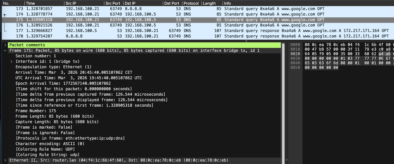

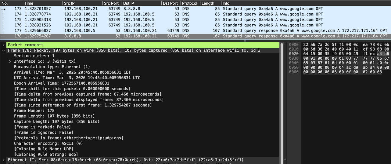

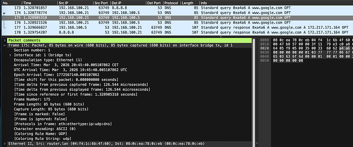

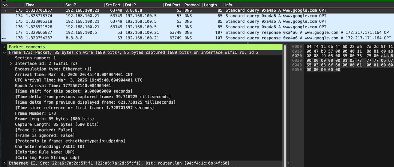

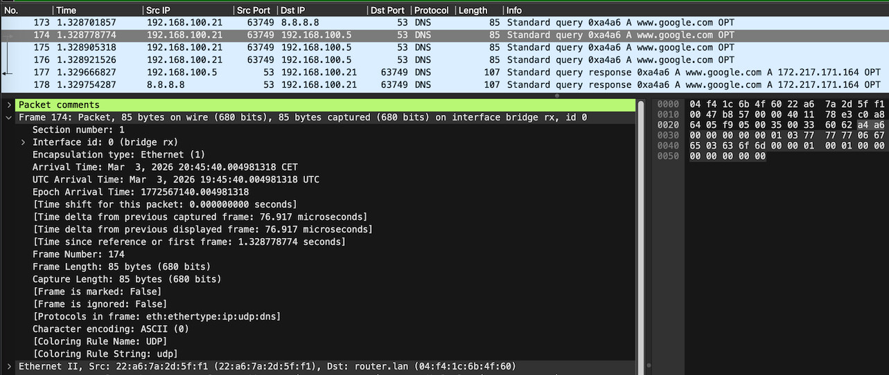

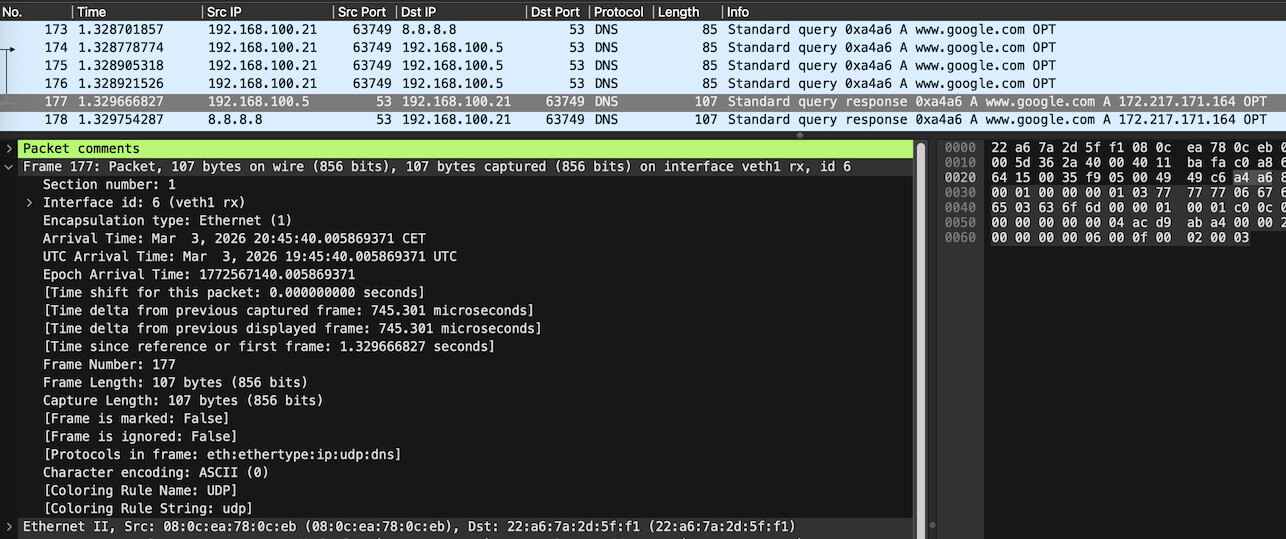

I captured packets for DNS request to 8.8.8.8 to resolve www.google.com (dig @8.8.8.8 www.google.com) from client IP 192.168.100.21 on wifi1 interface. Pi-hole is running in container with veth1 interfce IP 192.168.100.5, both interfaces are assigned to ports of same LAN bridge. There are two dst-nat rules related to this:
add action=dst-nat chain=dstnat dst-address-list=!DNS dst-port=53 protocol=udp src-address-list=!ALLOW_DNS to-addresses=192.168.100.5 to-ports=53
add action=dst-nat chain=dstnat dst-address-list=!DNS dst-port=53 protocol=tcp src-address-list=!ALLOW_DNS to-addresses=192.168.100.5 to-ports=53
DNS address list contains my local DNS servers IPs (192.168.100.1, 192.168.100.5, 192.168.100.7) and ALLOW_DNS list has IP list which are allowed to query external DNS servers (IP 192.168.100.21 is not in that list).
Only NAT masquerade rule I have is from defconf for WAN and it is not related to this flow:
add action=masquerade chain=srcnat comment="defconf: masquerade" ipsec-policy=out,none out-interface-list=WAN
Here are captured packets for DNS request mentioed above:
Now what is interesting are 2 last packets with same MAC addresses (src of veth and dst of wifi client) but with different src IP (and client has expected src address in last packet), which rule does that translation even there is no masquerade rule in this flow?
Did you do the capture on the router? Then from 177 -> 178 is conntrack undoing the DSTNAT, it just performs the reverse of what happens when DSTNAT kicks in between 173 -> 174.
