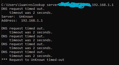

I used NSLookup to poll the mikrotik directly:

Ahh, second-to-last rule in posted firewall config is rule
add action=drop chain=input comment="Drop everything else"
which takes care of … well, everything :wink:
Co add a rule
add action=accept chain=input comment="DNS from LAN" in-interface-list=DHCP protocol=udp dst-port=53
or something like that (adjust in-interface / in-interface-list property) and push it above the previously quoted “drop all” rule. Keep in mind that firewall rules are processed from top to bottom and first matching rule executes (and stops processing of packet).
Or, if you can’t set sensible in-interface / in-interface-list for that rule, go with two rules (again, both above the drop all rule) in this order: first one dropping DNS requests from WAN and second one allowing DNS requests from everywhere (but WAN requests will be dropped already).

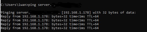

That was it!!
It works now! Thanks!
I used the bridge as the interface
