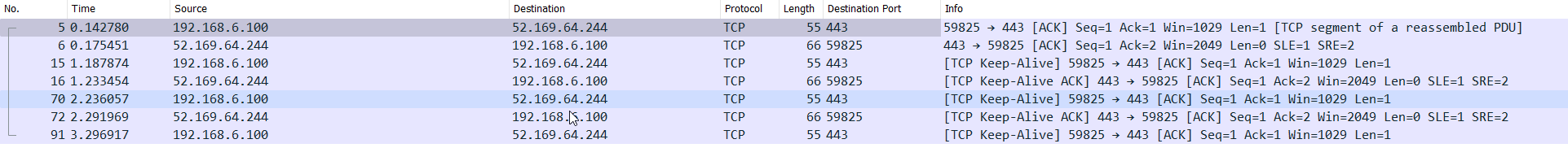

I was able to determine with Wireshark that Win11 was making the following call instead of the DNS query to my local DNS in the exact Moment where the DNS query should be made:
I think this might be a DoH call on a Microsoft server. I have tried several times and always found this call in Wireshark.
How can I get WIndows to stop doing this?

Ok now I am completely confused.
I have blocked the IP 52.168.64.244 in the Windows firewall and now I receive DNS requests all the time, as expected.
