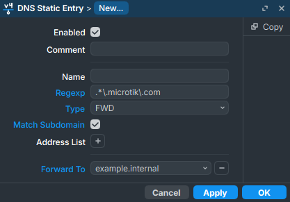

Have you read this: DNS - RouterOS - MikroTik Documentation
example says that /ip dns forwarders just set the pool ofDNSes to be used in the round robin style.
Configure/add a static DNS FWD entry:
/ip dns static add forward-to=example.internal name=mikrotik.com type=FWD
Now each time when a router will receive request to resolve mikrotik.com, request using round-robin algorithm will be forwarded to 192.168.3.207 or other DNS servers in the "example.internal" pool of servers.
Ont he other hand AFAIR you have to use regular expression in the static forward rule as the above line adds forwarding just for microtik.com, not for all subdomains of *.mikrotik.com
Edit: try this
Isn't the “Match Subdomains” checkbox doing the subdomain handling?

@aaaajeeee
No ... you just set the pool of forwarders (DNS servers you want to do the service) that is named "comfortuin.internal" - you can use any name for that - with one entry 192.168.3.207 .... it's like setting a pool of addresses for DHCP server without setting rest of DHCP server.
Do not mix these two concepts: the name of the forwarder(s) pool and the name of domain you want redirect resolveing process for. They could be the same just for convenience but I would add eg. "_fwd_dns_pool" to the name of pool
/ip dns forwarders add name="comfortuin.internal_fwd_dns_pool" dns-servers=192.168.3.207
Next you have to inform DNS what domain (in your situation it is the domain you used as the name of forwarders pool) you want to be resolved by already set forwarders pool by pointing it.
/ip dns static add forward-to=comfortuin.internal_fwd_dns_pool name=comfortuin.internal type=FWD
@Ddram
You are probably right that "match subdomain" ads "the magic" to the pure domain name so my solution just wastes resolver's time. I not tested it ... it was just proof of concept.
