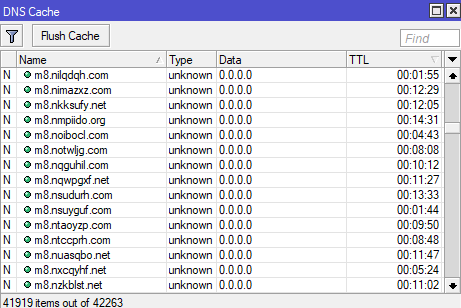

I’m noticing a high CPU usage at different times of the day and after using the profile tool, it appeared DNS was the culprit! I checked DNS and noticed the cache is increasing rapidly and filled with weird entries.

I get the same unknown entries; except the entries are for internal nodes on intrAnet..
I already have the DNS firewall rules in place for WAN.. why do I get these UNKNOWN type entries in MT DNS cache??

Same here. I don’t have high DNS CPU usage but I DO have the unknown TYPE DNS entries in cache all internal…
Don’t know what is causing them. Infected PC on the intrAnet…? How can I debug this, how can I track to the root?
