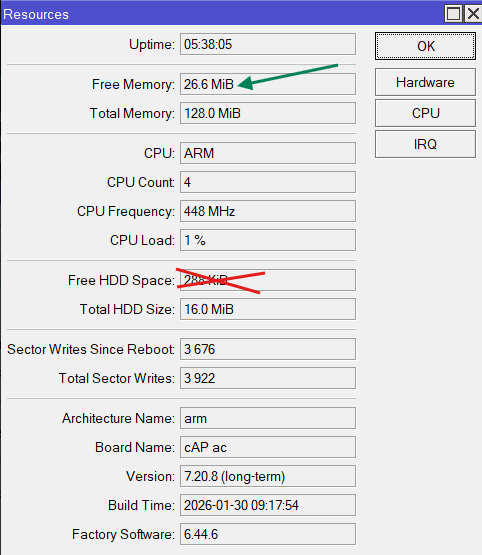

The DNS cache is in the memory (RAM) only so it will use what you have 26.6MiB left:
It doesn't use the flash storage, which is the persistent storage (of what you have 288KiB free).
You can keep the DNS cache at 2MiB without problem on your device.
