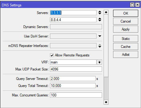

DNS Server set up for LAN with primary server being 1.1.1.1 (Cloudflare) and secondary being 8.8.4.4 (Google)
Allow remote requests is enabled, but I have two rules blocking all traffic on TCP and UDP for port 53. Action is set to drop. For some reason the UDP rule seems to have an unusually high amount of traffic.

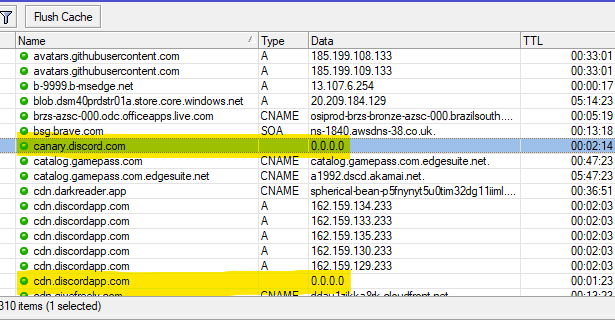

For some reason, my Mikrotik sometimes resolves addresses to 0.0.0.0. This happened a long time ago (>6 months), went away on its own, and now came back**. No configuration changes were made before this issue reapearred.**
What I tried:
  • Flushing the DNS cache
  • Restarting multiple times
  • Changing DNS servers
(I know, not a lot but I’m running out of ideas)
Could someone be messing with my DNS server even though I have a rule to block all outside traffic on port 53?

For me an IP address of 0.0.0.0 indicates using AdList. Could that be the case (it will be shown by the output)?

Anyway, it seems like they're injecting answers into your DNS...
Try changing your DNS to two that aren't too public,
so you can be sure they won't be spoofed from outside...

set allow-remote-requests=yes max-concurrent-tcp-sessions=50 servers=1.1.1.1,8.8.4.4
I don’t have AdList set up

if you don't want things to APPEAR one way or another,
always provide details...
True, though a question asking for more information could have been made in the first comment like erliden did.
“Why 20 sec?”
Why 10s?
Rather than explaining the effect of setting the timeout higher or how it could be affecting DNS requests, this reply does not give me any reason to change the timeout to 20s, so it’s not helpful feedback really. Even if you are right, you cannot convince people that your choice is right / objetively better / whatever if you don’t explain the reason.
as I'm concerned, that's not the only thing I wrote.
And this is also not helpful. As far as I’m aware I have been checking everything other members and you have written. Dropping “ah but you missed something” and not saying what it is does not help.
Please don’t take this personally. I have been through different processes that required me to both give and receive feedback, hence some of the feedback I am giving you was given to me at some point. I hope you find this useful like I did, and again, thanks for all the help so far.
The reason the default timeout was increased to 30s is that with a short timeout, the service might reply after that time and the reply is discarded rather than added to the cache.
While the DNS timeout will usually be set to a much smaller value, a delayed reply could still be useful for later queries.

The question was why you changed it, versus leaving it at the default, which is NOT my preference, but the default...
And a 30-second timeout is better anyway.
The reason for this is unrelated to the DNS issue, but it improves the other fields. (See also @pe1chl reply...)
Discussing this here would have been off topic...
(v6 20s, v7 30s defaults???)
