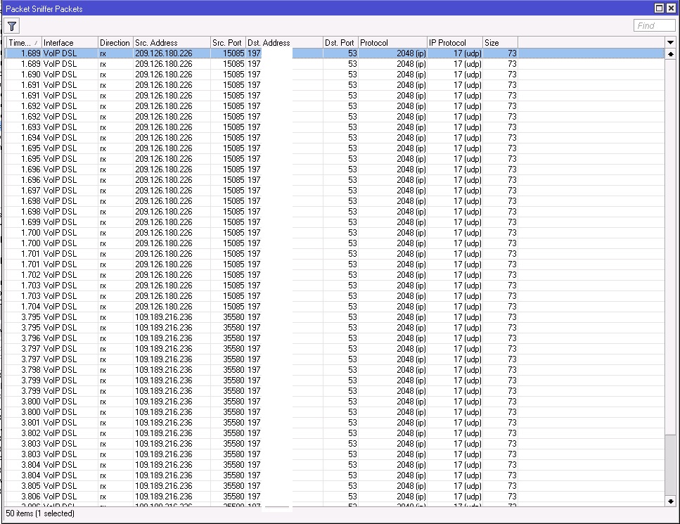

I noticed something weird earlier today,
My one dsl line is current not active (ie there are no devices routing through it).
It is my backup line.
But I noticed every second there was a full upload spike on my PPPoE interface.
I packet sniffed the traffic and I got the following:
I dont have any devices talking on this interface so it can only be coming form the outside.

Does this mean that some one is using my router as a DNS server?
I have added a temp firewall rule to drop incoming to port 53, But then will this not disable me to do dns resolution as well?
If your rules are on the “input” chain, matching only dst-port, then no - it won’t disable your router from making DNS requests, and/or disable receiving of replies to them.
