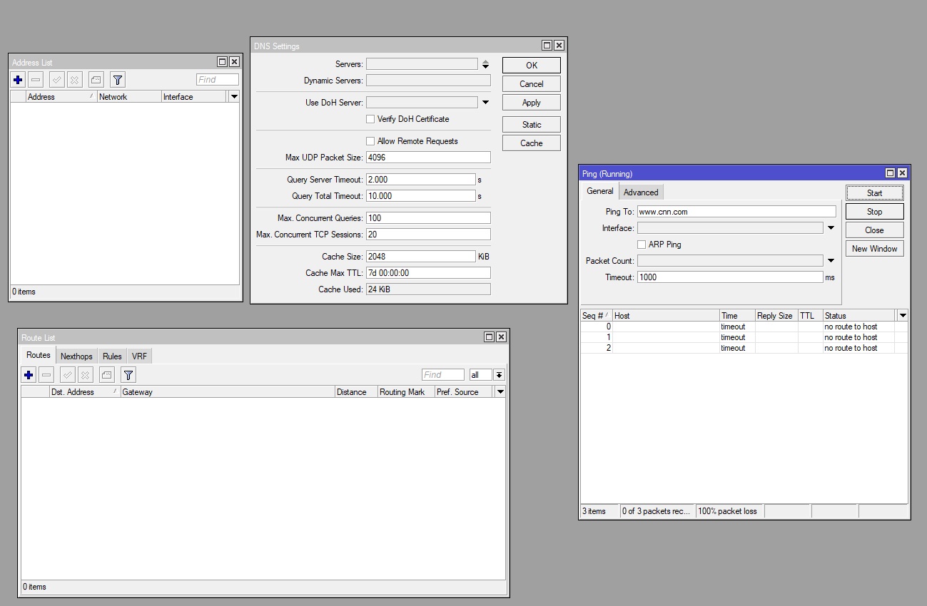

why does the Ping-tool resolve “www.cnn.com” to 151.101.1.67?
The router has no config, no IP, no route(s) and even no DNS server entry:
Perfectly resolved DNS in an IP…

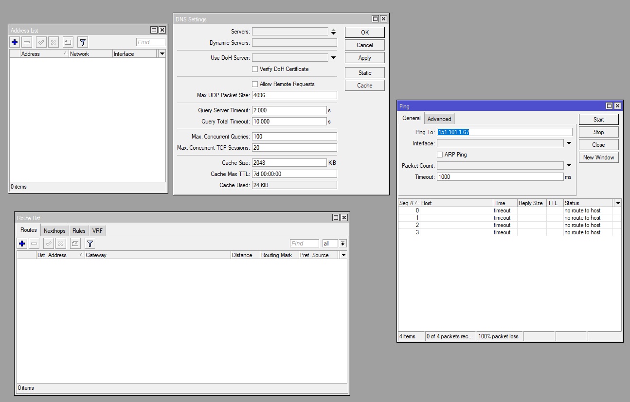

And even more suspicious, a packet-sniffer shows nothing related to a DNS resolution…
How (and why) can the router resolve the DNS-name in an IP?
The host is resolved in Winbox on the client device..

Have you cleared DNS cache?
Winbox is using your computer’s DNS settings.
resolve command in terminal is using the router’s DNS settings.
-Chris
