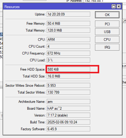

I had same problem! Memory was full. I had zeroes in red square on picture. I had to delete everything I could delete from internal flash manually. 100KB was freed. After that I reset mikrotik. And problem solved!
