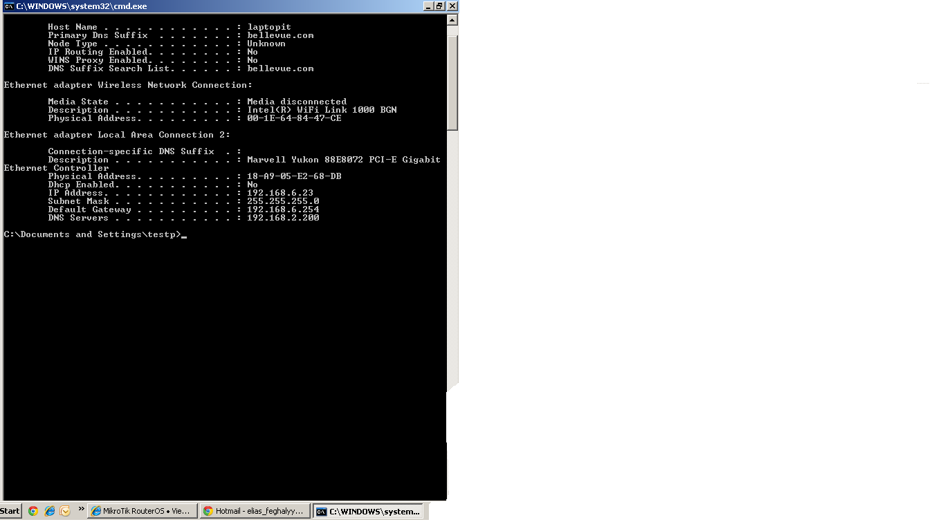

show us your windows “ipconfig /all” result, and the router configuration of “/ip dns print” and “/ip dhcp-server lease print”
windows ipconfig / all
now your routeros config. 192.168.2.200 is your router? what is in it’s ip dns settings"?

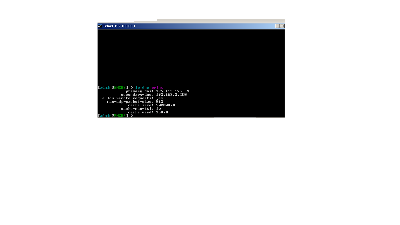

mikrotik : ip dns print
don’t post images, use copy and paste, and paste the text
mikrotik : ip dns print:
[admin@BMCHS] > ip dns print
primary-dns: 195.112.195.34
secondary-dns: 192.168.2.200
allow-remote-requests: yes
max-udp-packet-size: 512
cache-size: 50000KiB
cache-max-ttl: 1w
cache-used: 15KiB
