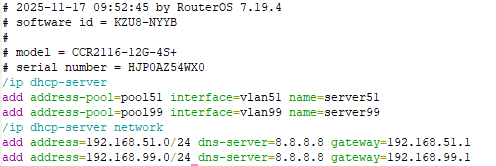

Could you share the output of:
/ip export
Together with ipconfig /all or ifconfig from a client

If that's the case, then the DHCP server settings on the MikroTik CCR2116-12G-4S+ have nothing to do with the problem. Verify what your Linux machine's DHCP server is putting out as DNS server and correct the issue on that Debian server.
Well the issues started after replacing the old router to the mikrotik, i thought that it might be the problem
AFAIK your router is missing its DNS config, there is no /ip dns and your WAN interface doesn't have this information as well.
Please remove serial number.
Thanks, I’ll see what i can do about this
Your problem seems to be that you have two dhcp servers. That’s incorrect.
You can have your existing Debian openvz be the dhcp, assuming you are otherwise satisfied with it. (A proper Debian offers way more administrative choices, so if you’re comfortable relying on it for dhcp/dns, I would suggest you keep doing so.) In this case however, remove or disable the dhcp server(s) on the Mikrotik. (As you have vlans, it’s fine to have the Debian serve as the dhcp on some of them and have the MT handle the others.)
If you want to use your new MT as the dhcp server, you’re free to do so. You will of course have to shut down the dhcp server on your Debian. In this case you can still advertise your Debian as the DNS server. Or you can advertise 8.8.8.8, etc. Or you can advertise the Mikrotik itself, in which case you’ll have to enable /ip dns allow-remote-requests.
In any case, configure proper dns servers on your Mikrotik in /ip dns servers. This is nice for it to be able to upgrade its software and other things, even if it’s not the dns server for your network.
