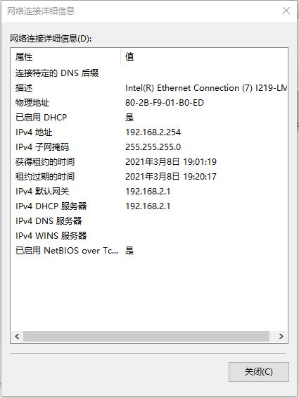

4.Computer got IP address from router.But the dns column is empty.
5.Replug the ethernet port or wait for morethan 5minute to get dns information from DHCP server.

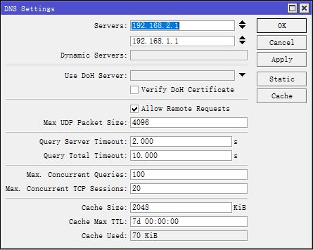

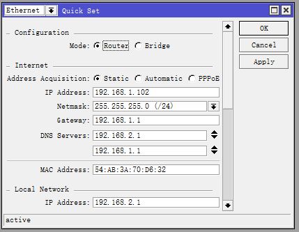

I made a test by setting the WAN port to a static IP address(192.168.1.102/24) ,defaule Gateway(192.168.1.1) and DNS server(192.168.2.1&192.168.1.1 )
I checked IP->DNS and the servers is 192.168.2.1 & 192.168.1.1

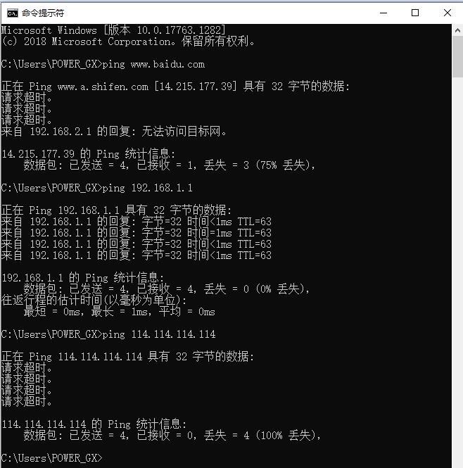

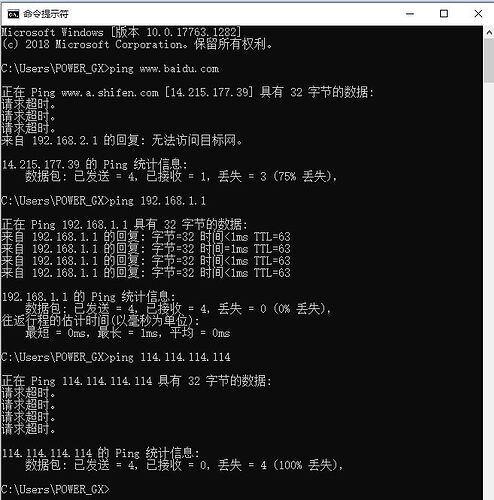

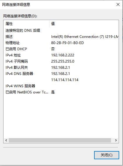

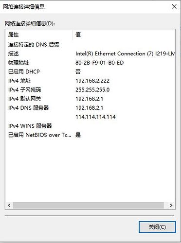

The odd thing is with setting WAN to static ip,I can not access to internet even by setting my computer address to static.(IP 192.168.2.222/24 Gateway:192.168.2.1 DNS: 192.168.2.1 & 114.114.114.114)
I disabled static address of WAN and reenable dhcp-clicent ,I can access to internet now.
setting computer to static ip address
ping baidu is not ok.ping wan gateway is ok .ping 114.114.114.114 is not ok

This is wrong! You specify your own address as a DNS resolver for the router to use!
You should put only external addresses here.

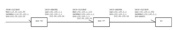

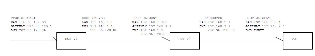

Picture below is the test environment.Ros v6 is the up router which works well. Ros v7 is the testing machine.Which get IP and DNS from up router.
The problem is PC got ip address from ROS v7 normaly whitch is 192.168.2.254 but the DNS column is empty.
If i configure PC to static address with LAN IP: 192.168.2.254 default gateway: 192.168.2.1 and dns: 192.168.2.1. everything works as expected.
The only thing is dhcp-clicent can not get dns information from ROS v7 DHCP-SERVER when router bootup.It takes nearly 5 minutes to wait for the imformation.
