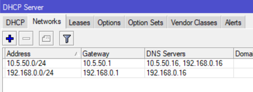

The easy one is to add dns on Ip>dhcp server>network> DNS server add your addguard ip there, i don’t use the netwatch script it kind of buggy sometimes
