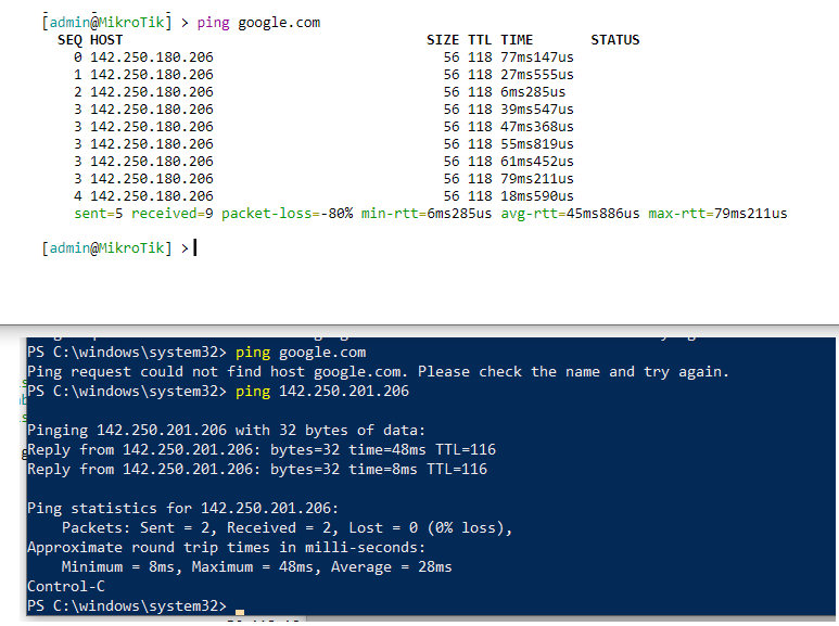

I don’t know if it is a failure or my mistake, but on the router I can ping domain names like google.com, but on my PC there is no name resolving. I can ping IP addresses without any problem, but no domain names from my PC. Does anybody have any idea?

I have few ideas:
a) Your PC has invalid DNS config. Check “ipconfig /all” for DNS servers.
b) There’s something wrong with configured DNS server. Is it router or something else? If it’s router, does it allow remote requests (see IP->DNS)?
c) Something interferes with DNS queries, most likely your router. Check its firewall rules.
DNS testtool for your PC is “nslookup”
C:\Users\bpwl>nslookup
Default Server:  Vigor.router
Address:  192.168.2.1
> google.com
Non-authoritative answer:
Addresses:  2a00:1450:4007:816::200e
          216.58.201.238
Commands:   (identifiers are shown in uppercase, [] means optional)
NAME            - print info about the host/domain NAME using default server
NAME1 NAME2     - as above, but use NAME2 as server
help or ?       - print info on common commands
... etc ......
> server 8.8.8.8
