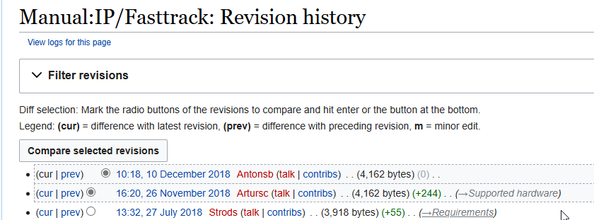

You are referring to a page last edited in 2018 to assess that feature for a device released in 2025 ?
I’m glad my RB5009 is not listed either then …
Wiki is no longer maintained (I assume). Please use RouterOS - RouterOS - MikroTik Documentation
