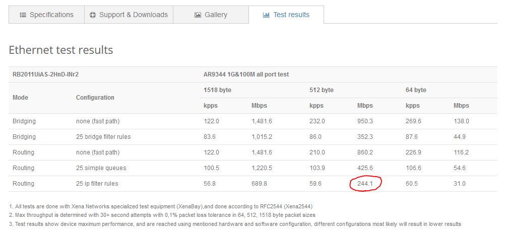

Yes, you should upgrade. For sizing, go onto the products page and look at the device “Test Results” tab, specifically the 512 byte packet 25 ip filter rule routing performance. That will give you a good general idea of the real world maximum throughput of your device. For the RB2011 it shows 244.1Mbps, which shows that it was just fast enough for your old service.
In some cases you can get a little more (with fasttrack etc), but for a reasonable configuration I would agree with sizing the RB2011 for a maximum of around 250Mbps.

The 25 simple queues is more representative of home setup throughput but yes that the right area to simulate one way throughput.
How so? I’d expect most home users to have zero queues defined and at least default firewall filter rules (around 10 IIRC).
Basing on real world experience with hex and rb450Gx4.
If you found it to be closer to 25 IP rules, then so be it, just passing on my intimate relationship with marketing numbers.
