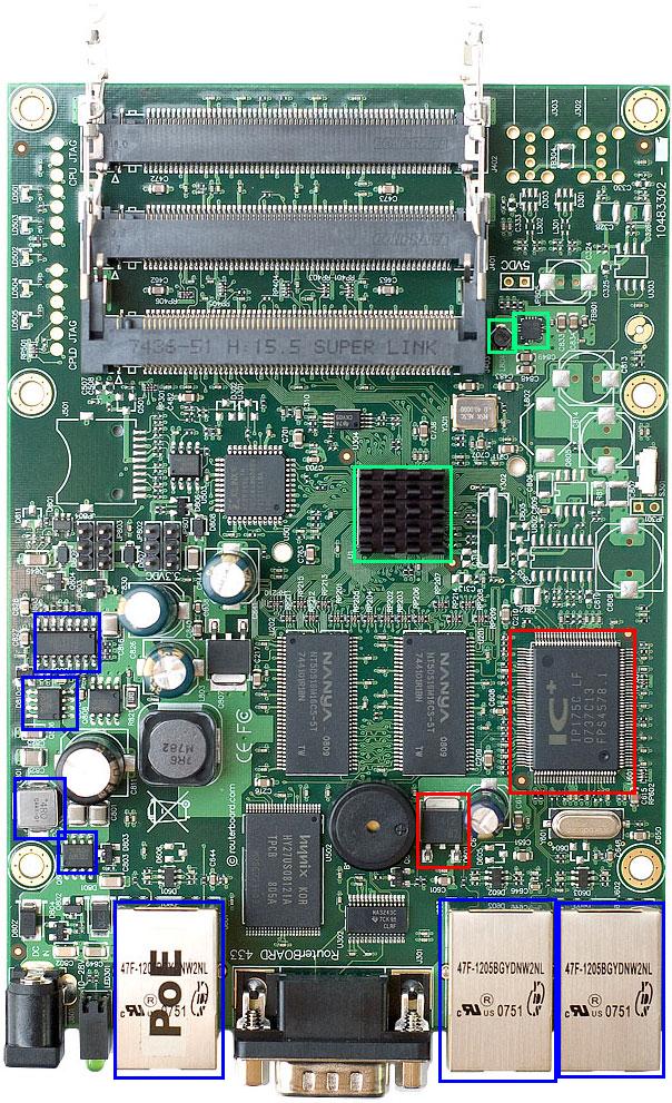

A picture with the faulty components that i’ve seen.
The blue components are changed to do the RB turn on.
The Red components are changed to me connect to Ethers.
The green components are changed to do the board boot.
->In the CPU just was made reflowed.

For the Ethernet connectors part. I haven’t ever changed them (if they weren’t mecanically damaged of course). Except the Ether1, that has the PoE pins, i don’t see how the others can affect the turning on of the RB.
Also. I wanted to ask. How do you test and measure the components in blue??
The Ether ports, I tested but don’t find nothing of different. So I knew that C826(3,3V) was short circuited with GND. I removed component by component and tested if fade the short. If you will try to repair a board that don’t turn on, I advise change first the J603.
In the other cases, I check the voltage of the pin 7 of U803 and isn’t 3,3V(like another that I was comparing).
The D801 and the Q801 I found easily the datasheet, and tested.
And the L801 was with a resistence diferent than 0 Ohms.

The question you are asking (about nothing showing in winbox) has happened to me many times with the new version of the RB411. I solved it by changing the ether chip. Even if it connects (green led on ether connector turns on), it doesn’t really work.
Mostly of the times is a damaged ether chip that looses packets in rx, tx or both ways.
The simplest test i do about the state of the ether chip is trying to boot the routerboard via ethernet with netinstall. If it doesn’t connect, even if the led is lit, i proceed on changing the ethernet chip..
After repairing i test with speedtest of MT and see if there is any packet loss.
Do you know a better way??
No… in the mostly of times, the buzzer(B1) of the board don’t honk. So I can’t boot the RB via ether with netinstall. :frowning:
Do you have any ideia? -
No boot is often a power problem. Check chemical capacitors. 90 % of problems do come from them.
Dissolder and check the value. 1/2 original value is generaly ok. 1/5 or 1/10 is not ok…
