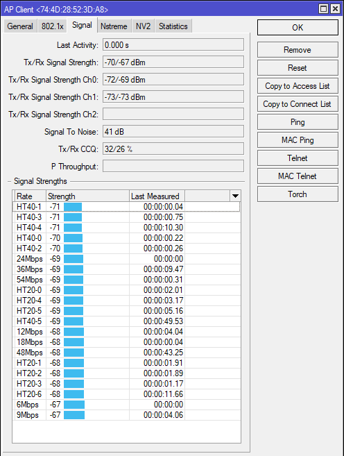

As you can see, link is established , but with a very very bad CCQ.
i played a little with the antennas:
  • swiched to debug country
  • forced frequencey to 2372 Mhz 20/40 Ce (if i got it right, it mean that i’ll go from 2372 to 2412 Mhz in 40Mhz mode)
  • still at 20dbm max (17dbm set in tx power) Edit: wrong, in fact i was transmitting at 17dbm but i forgot to add the 21 dbm of antenna…

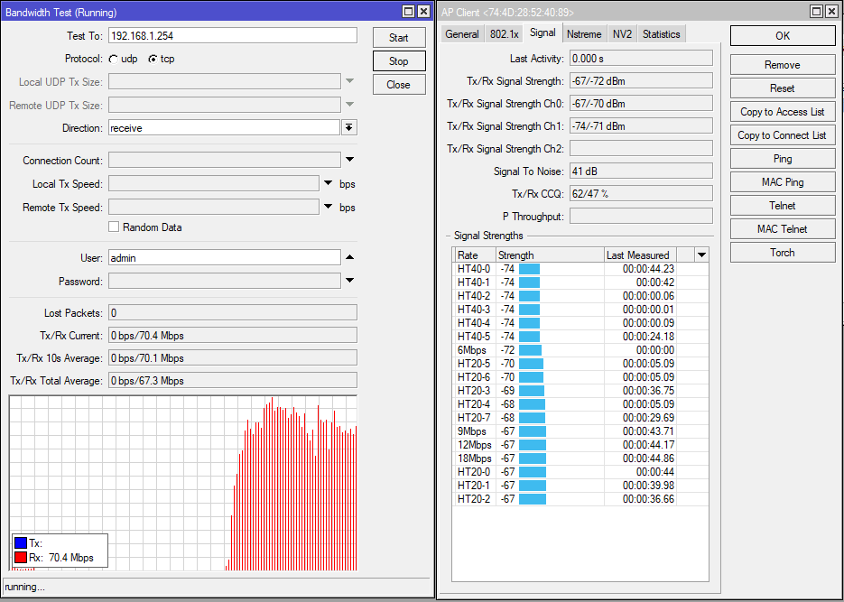

Home:
Distant site:
Hu, hoooo much better!
with same tx power i now get between 40 and 50% of CCQ and 50 to 60 Mb/s instead of 4 Mb/s…

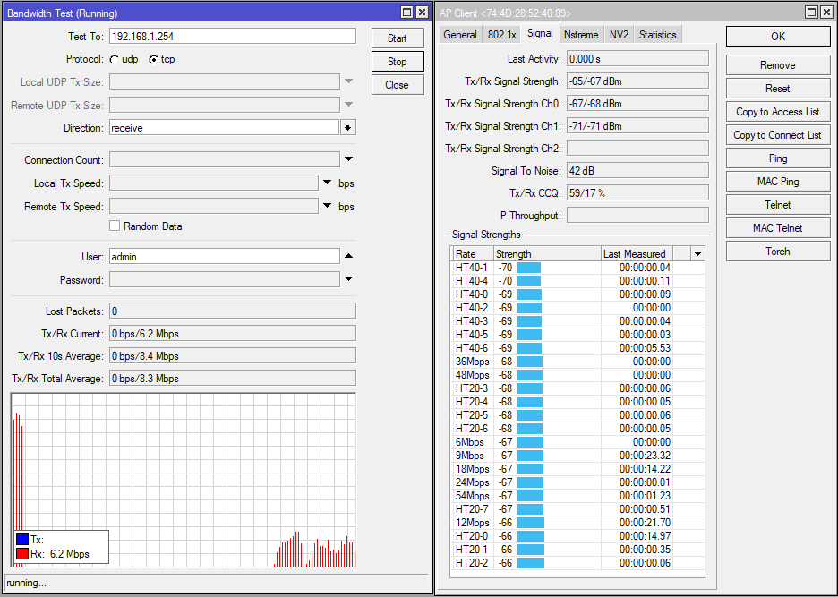

I played a little more, increasing TX power to 20 dbm (so 23 dbm total) which is 200 mW (if i’m not wrong) instead of 100 mW
Edit: wrong, in fact i was transmitting at 20dbm but i forgot to add the 21 dbm of antenna…
and the results are:
Frequency: 2412 (legally ok for frequency, not for power)
(I only show the house side)

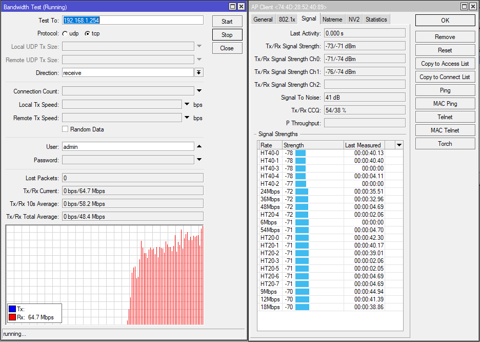

Frequency : 2372 (not OK for frequency, not OK for power)
and, on 2372, with 400mw (26 dbm if i’m not wrong), i get 100 Mb/s.

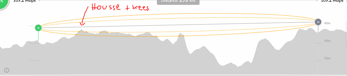

for infromation, i also watched on ubiquiti website (they have a nice tool for ptp estimation)
and here is the line of sight: there is a house + few trees on the line of sight.

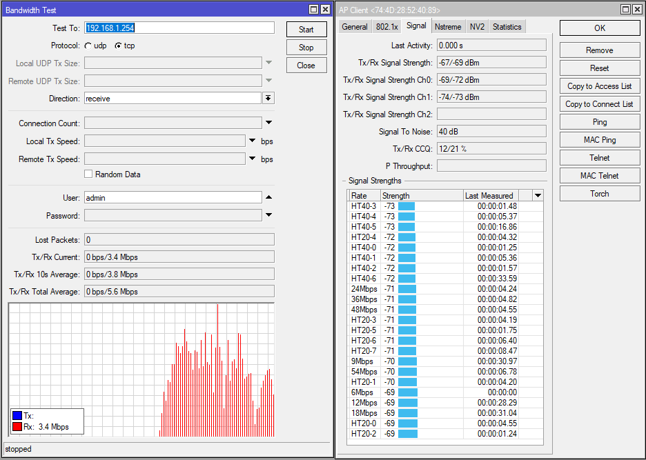

using 250 mw (gain 21dbi + 3tw power manually set) , i’m able to get a link at -81/-84
CCQ is between 7% and 18%
data rate is 7.5Mb
and it’s by using 250mw instead of 100mw legally allowed…
