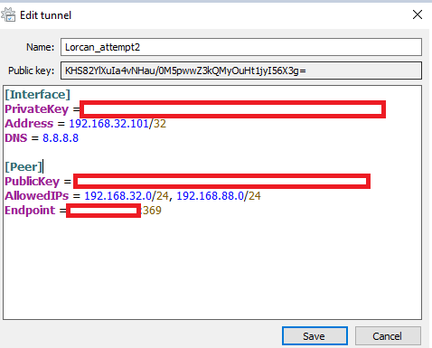

(2) Your client is missing the persistent-keep-alive set to lets say 35s

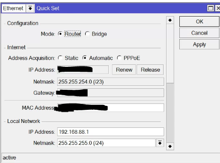

I have attached a pic of the WAN settings, its ‘Automatic’ as opposed to ‘dynamic’ that I said earlier
Note: My internet is working, I am accessing the workplace via chrome remote desktop thats how I am doing the configuration. So the internet is definitely working. Just I think it might need to be PPPoE for me to get the static IP from ISP

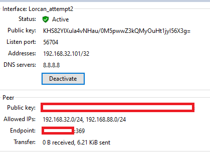

Here are the wireguard settings when I have it active. I am typing ‘ping 192.168.32.1’ into command prompt, which is why you can see some data is being sent.

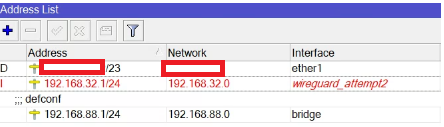

Is it normal that ‘wireguard_attempt2’ is in red in IP->Adresses?
