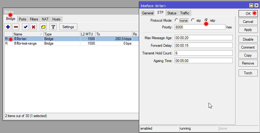

Yes indeed
Go to bridge, click on a bridge, click on tabblad STP select RSTP ore STP
