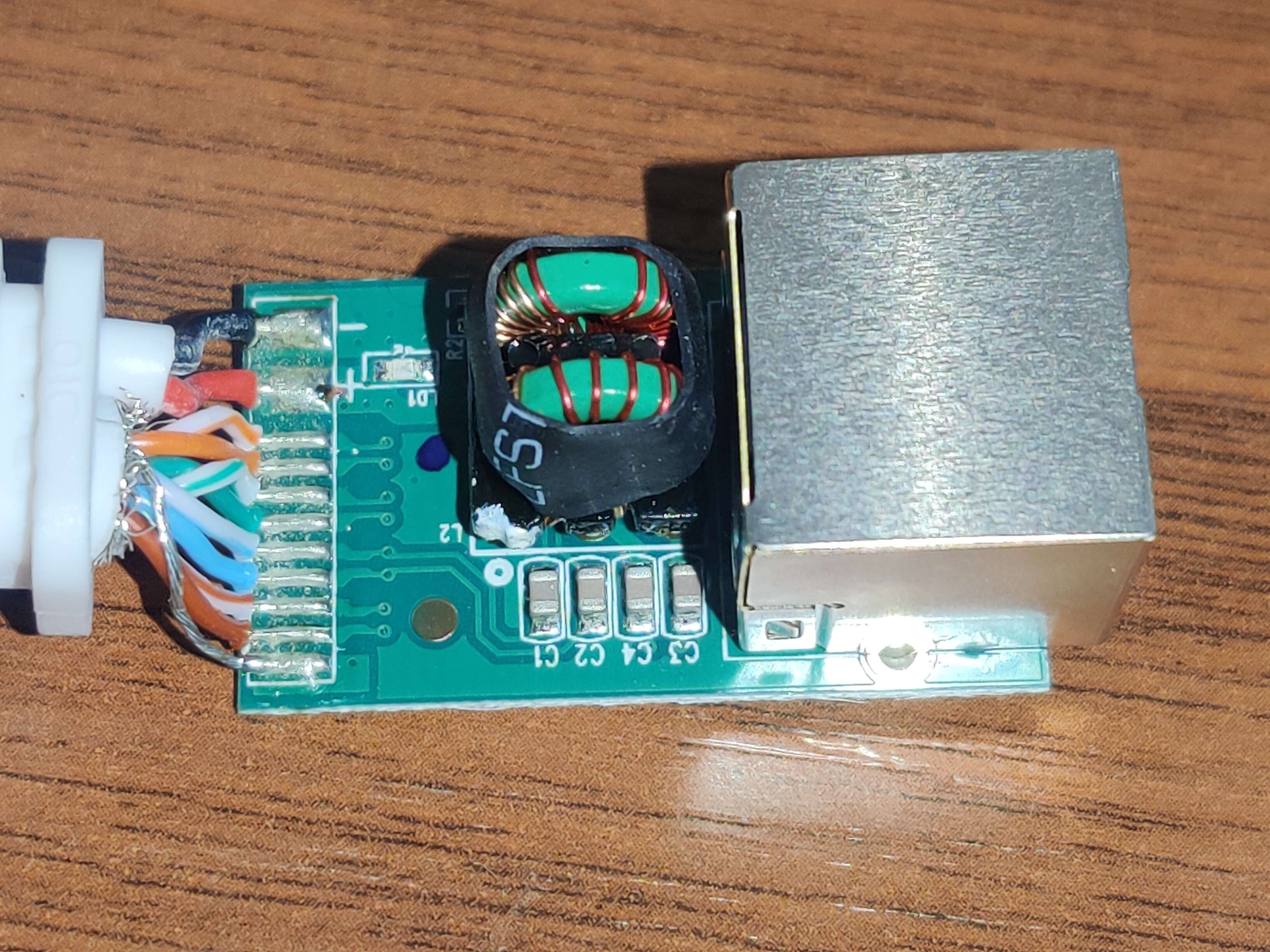

I tried to find disassembly for injector or schematics or clear answer but no success.

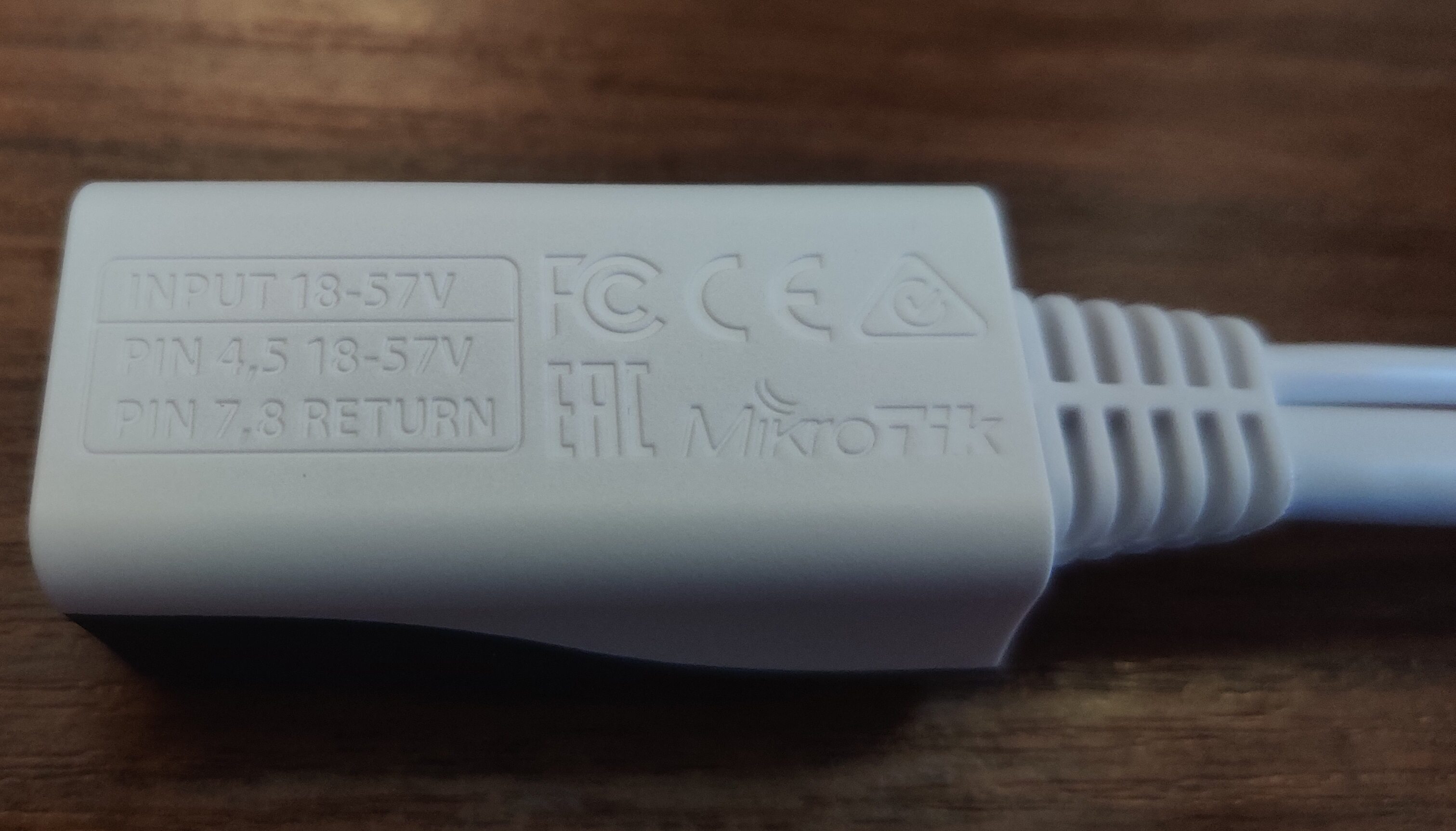

The unpowered side is safe to use with any hardware, it’s just a standard Ethernet cable. Power only goes out the powered side - make sure you connect that side to ONLY Mikrotik devices, it’s non-standardized passive PoE so it is unsafe to use with any 802.3af/at hardware as it constantly supplies voltage without any sensing.
R1CH, thank you!
I confirm, other side no under Power Source voltage. Voltmeter readings are about 0 for both DC and AC.
I wonder what happen if capacitors short circuit)))

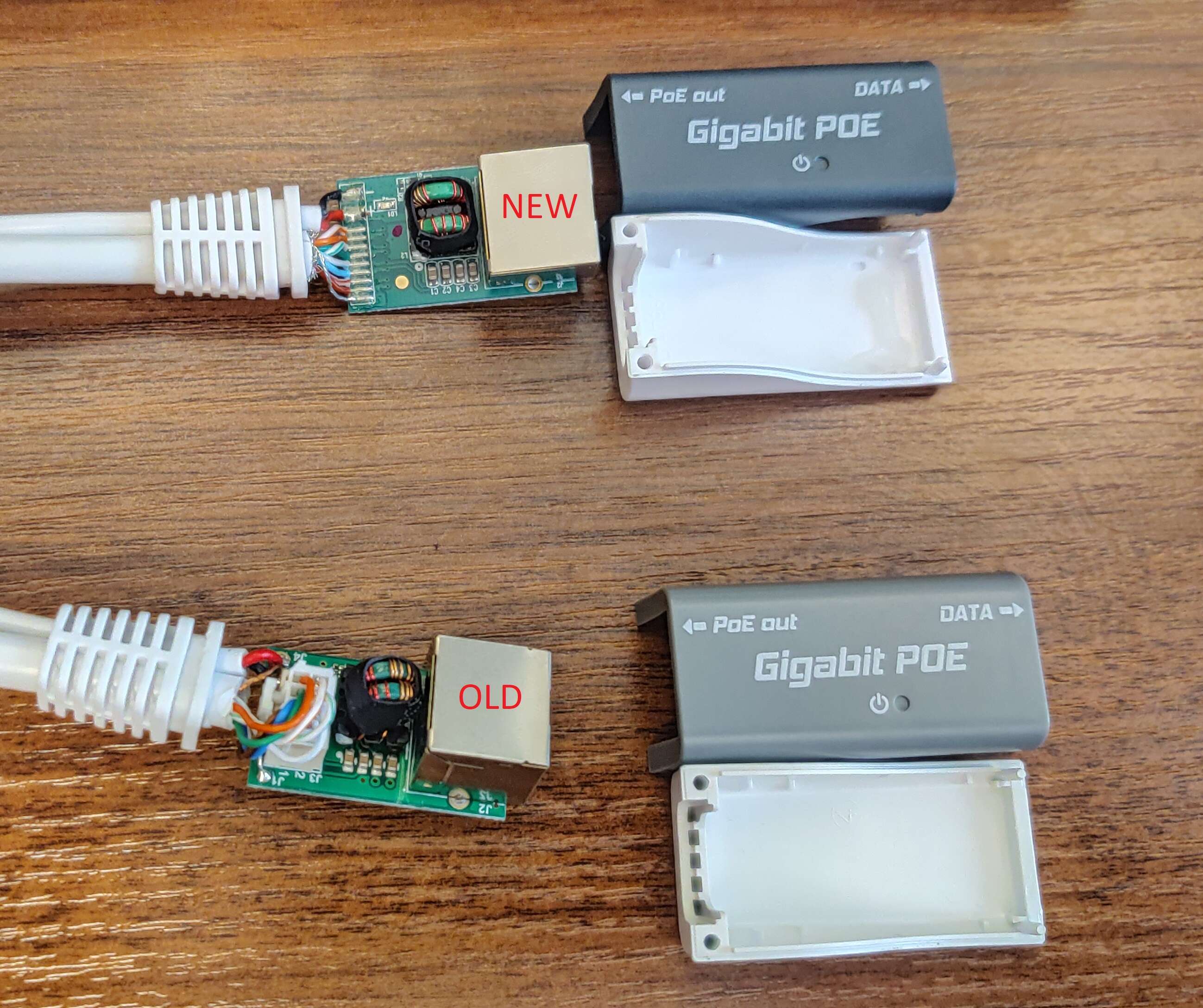

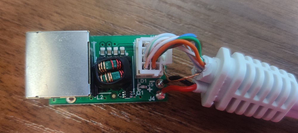

in case of any interest - another model.
Harder to disassemble - tight connection.
Darker body color.
Blue light diode more bright.
Works as expected. Both able to POE-IN POE-OUT set.
Same jack 5.5mm x 2.1mm.
