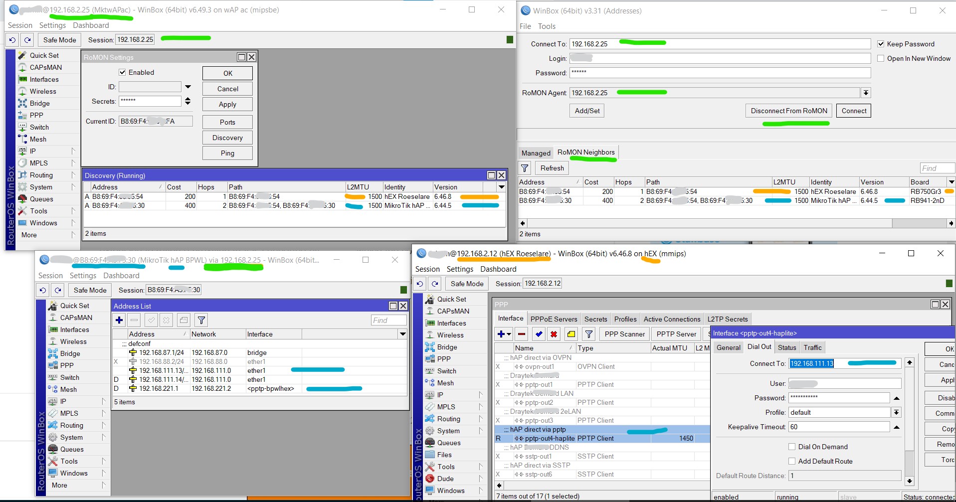

The details of my test (192.168.x.y) … starting from a laptop (2.41) connect to wifi to a hAP ac2 (2.23) , which is on the same L2 network as the wAP ac (2.25) with RoMON enabled.
Connect with Winbox to “Connect to RoMON” on the wAP ac (green markings on screenshot) . So far only wifi and ethernet is used, all is bridged, and on same L2 network.
On the same network is also a hEX (2.12) with RoMON enabled, same secret) (orange marking on screenshot) . That hEX makes a tunnel to my hAP Lite (tunnel concentrator). The tunnel uses IP subnet 221.0/24 network for the 2 endpoints. Tunnel can be changed for testing PPTP,SSTP or OVPN.
The hAP Lite is NOT on the same subnet. It is separated and is on the WAN side of my Draytek router/firewall. The hEX on the LAN side (2.0/24) can reach a device on the WAN side. (111.0/24)
If connected to the hAP Lite wifi , nothing on the Draytek LAN side can be reached. There is no L2 connection either besides the tunnel. There is no routing defined over that tunnel.
On the laptop the hAP Lite MAC address is chosen in RoMON Neighbors as given by the RoMON Agent wAP ac. (blue marking)
RoMON discover knows about multiple hops by itself. wAP ac → hEX → hAP Lite. RoMON passes over ethernet from wAP ac to hEX, and over PPTP from hEX to hAP Lite.
The hEX is not selected at any time. It’s the intermediate RoMON device, the 3 RoMON devices have the same secret. No other MT has RoMON enabled.
The PPTP tunnel, just as the SSTP and OVPN did, clearly carries the RoMON interdevice and MAC based traffic. EDIT: NOT! See edit below
The tunnel endpoints are NOT connected to the local bridge in hEX and hAP Lite. The only IP routes are the automatic ‘distance=0’ route for the connected network 221.0/24.
Sorry to blur some things a bit in the screenshot.
EDIT: this test is not as expected. There is a “forgotten” other path between the hEX and the hAP Lite, not passing over the Draytek router but also using ether1 on the hAP Lite (so same MAC address.) That path is used for RoMON !

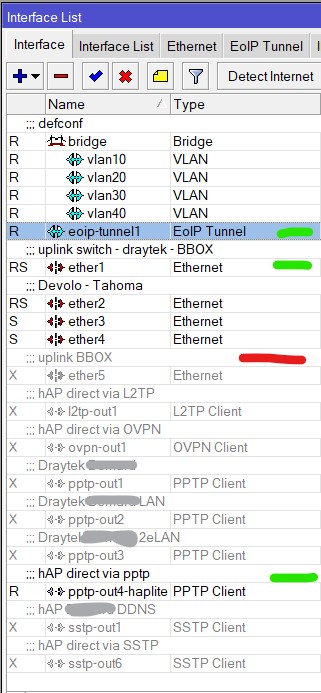

My bad. My bad test. In the long running transition of replacing the Draytek with the hEX, the hEX also got it’s own WAN connection, so Draytek, hEX and hAP Lite are in the same LAN of the ISP modem.
Forgot about that “ether5” connection on the hEX, sorry for that, as it is not actually in use yet for all user traffic. (only some VLAN)
It answers the question: “Does ROMON bypass firewall rules?”. Yes it does as hAP Lite and hEX are connected with their mutual WAN ports, and cannot communicate except for the allowed tunnel.
Disabled “ether5” and did test again … Aaaargh … PPTP does not carry RoMON, the traffic counters I saw were those for SNMP and Syslog from and to the hEX/Dude.
Idem dito for SSTP and for OVPN. (OVPN is connectable to the bridge, but not done here). None of the 3 protocols worked for RoMON discover.

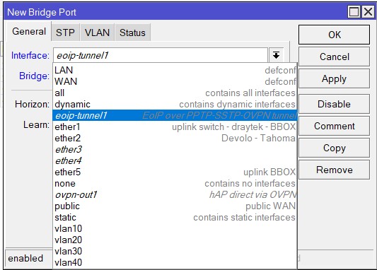

OK next step then. Just added EoIP over the PPTP link. Yep that worked, and “ether5” IS down this time. Multihop works as well as discovery.
EoIP tunnel is not a port on the bridge.

EoIP is creating a bridge port-able interface : “eop-tunnel1”. Just used the IP address of the far end of the PPTP tunnel for creating EoIP, and tunnel ID = 1
OVPN also has a bridge-port selectable interface, but is not carrying RoMON multi/broadcast. SSTP and PPTP are not selectable as bridge port.
