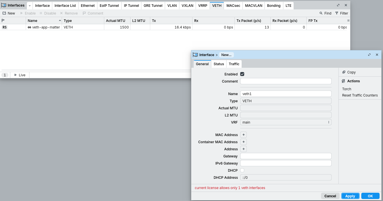

Does routeros x86 Level 1 license (Free Demo) has a limit on VETH devices?
Hi. I'm considering the routeros x86 as an option for my home router on a mini pc and currently testing it on a Free Demo (level 1) license, before committing to purchase a full one. I plan to run a few containers on it, like OpenThread Border Router (OTBR) and a Matter server.
While exploring the apps and containers, I've stumbled on this limit, which I assume is due to the Demo license:
current license allows only 1 veth interfaces
I couldn't find anywhere in the docs or old wiki references to it though. The license levels table mentions only the various tunnels and user number. What are the exact limits for VETH on higher licenses?

This is not on CHR, but on bare metal x86. And I don't think this is tied to apps/containers specifically, but any time i try to add more than one veth interface, even manually - the error message is returned.
Ah.... Never tested bare-metal X86. You might file a ticket with MikroTik. The docs don't list VETH as restricted, but yeah all the ethernet-like interface are limited to 1. But you're correct this does limit testing of /app in trial on native X86. But at least this makes more sense since I was very confused since I'd never see the VETH limited to 1 message EVER.

I've got response from mikrotik support. They've updated the x86 license docs:
The demo license limits the router to a single interface. This restriction applies to multiple interface types (veth, vlan, vxlan, etc.), not only those listed in the table
Regarding the suggested limit on higher licenses above (20/50/unlimited) - this is also not true: support stated there are no such limits on the paid licenses. I've just tried myself, and on L4 was able to create 50+ VETH interfaces without hitting this error again, thus I believe that it is unlimited.
