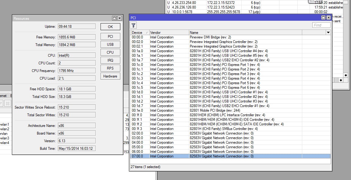

Guys have any of you had a issue yet were a rb 2011 seems to be performing better than a x86 machine??? i have a 6 port x86 machine and for some reason i cant seem to get better performance out of it…reason why i want to go over to the x86 hardware is that it has a ssd in it and alot more processing power.
specs are attached.
Any help will be appreciated. or any ideas on how to optimise…

I see you have Pineview Atom based board. I’m also using similar Cedarview Intel DN2800MT board but with only one 82574L onboard network controller using VLANs and HP ProCurve 1810G-24 L2 Managed Switch. I can simply NAT 200Mbps to my provider (at 40-45% CPU load) and 100Mbps PPTP VPN MPPE128 also possible with this CPU. I can only recommend downgrade to ROS 5.19-5.26. Your hardware seems older than Cedarview, so ROS 5.19 should support it.
