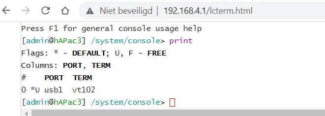

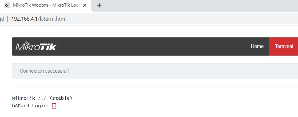

Thanks, there might be issues, but on my HAPac2 it does work well with v7, just tested it, could connect via WOOBM:
[admin@ut-r1] /system/routerboard> print
       routerboard: yes
        board-name: hAP ac^2
             model: RBD52G-5HacD2HnD
     serial-number: E5780F4848A2
     firmware-type: ipq4000L
  factory-firmware: 6.45.9
  current-firmware: 7.8beta2
  upgrade-firmware: 7.8beta2
Must be 5009 then, as hAP ac3 ROS V7 is no problem.
What firmware have your WOOBM? (on bottom of the settings page)
I put my WOOBM already away, but I know I have installed the file: woobmfw_211105.bin
That file is still on my laptop…
:confused: I hope on more recent version that fix the issue…

I don’t have any handy, but I’d image a USB to serial adapter work if it showed up under /port… Then it could be assigned to console in /system/console – before you’d needed for an “emergency”. Just plugging in the serial-to-USB is likely going to do nothing since RouterOS wants you to assign the port to some service, of which console is one possibility.
My version v1.1.
Once had a problem on hAP ac2 , with the already defined system/console. Deleting console solved the problem.
EDIT: with some luck and fail-safe RouterOS design :slight_smile: .
https://wiki.mikrotik.com/wiki/Serial_Port_Usage
“as RouterOS will recreate the console after the next reboot when you really remove it.”
“When rebooting a RouterBoard the bootloader (RouterBOOT) will always use the serial console (serial0 on RouterBoards) to send out some startup messages and offer access to the RouterBOOT menu.”

It can be made even easier from two USB to TTL boards (super cheap from China, <$1, just get FTDI chips as they are least problematic), connect RX->TX, TX->RX, GND->GND and it’s done. Easiest OOB management from one Mikrotik to another.
WOOBM contains ESP8266 MCU for dealing with wifi/serving web pages and USB to UART module so it appears as USB serial device/adapter on Mikrotik.
So it’s USB serial console terminal with WEB UI.
