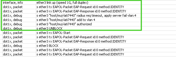

I get unexpected behavior with Dot1x + server-fail-vlan-id on wired network. My setup is following:
  • freeradius server is down
  • authenticator is CRS326, RouterOS v7.13
  • only dot1x Auth type is enabled ( no mac auth)
  • supplicant is Windows 10, IEEE802.1X enabled, Fallback to unauthorized network access is enabled
After Radius timeouts I expect port to be moved to server-fail-vlan-id and EAPOL to stop until Radius is back online. What actually happens is that after supplicant is correctly moved to server-fail-vlan-id the EAP process is still running and causes port to flap.
Logs - the green part is OK, what comes after is not, supplicant looses connectivity. This keeps repeating.
