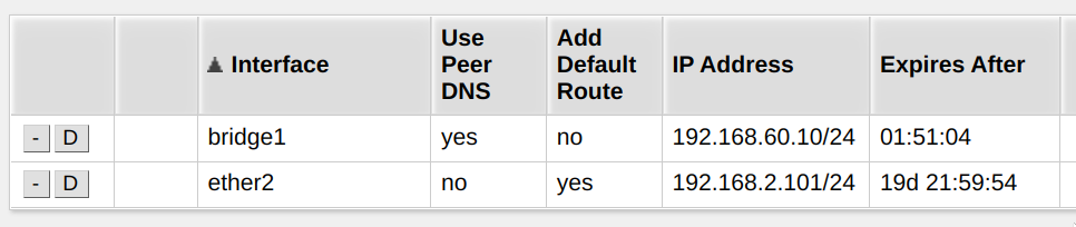

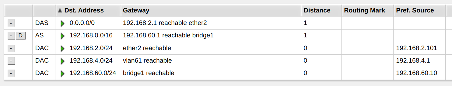

Edit 1: I will try to clarify my third question. There are two dhcp-clients on the hEX. One on vlan1 (my management vlan) and one on vlan11 (my lte vlan). The idea is to route any traffic that does not target RFC1918 to the gateway set by the second dhcp-server (through vlan11) and anything else to the gateway set by the first dhcp-server (through vlan1). How do I do that without having to enter the gateway ips manually, like I did in the above config?
Edit 2: I think I can answer the second question myself now. It simply simplifies the configuration:

/ip dhcp-client
add add-default-route=no disabled=no interface=bridge1
add disabled=no interface=ether2 use-peer-dns=no use-peer-ntp=no
add address=192.168.4.0/24 gateway=192.168.4.1 netmask=24
add action=drop chain=input in-interface=ether2
add action=masquerade chain=srcnat out-interface=ether2 src-address=192.168.4.0/24
add distance=1 dst-address=192.168.0.0/16 gateway=192.168.60.1
