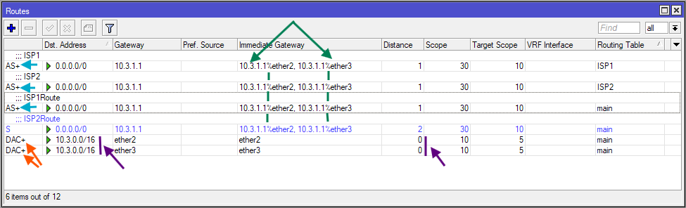

When you configure the IP addresses on the interface like this:
You create two ECMP connected routes for the destination 10.3.0.0/16. ECMP because the destinations are the same and the distance are the same (purple arrows in the screenshot above). As a result, the two routes have the + sign (orange arrows) which denotes ECMP (equal cost multi-path).
Afterwards, it doesn't matter what distance values and tables you choose your default routes (destination 0.0.0.0/0), if the gateway is specified as 10.3.1.1. Next-hop lookup will see that the destination 10.3.1.1 have the best route which is the ECMP group with destination 10.3.0.0/16. As a result, all the 4 routes with the green marks you see in the screenshot become ECMP routes too (see + signs with blue arrows), and all have the same two possible next-hops / immediate gateway candidates.

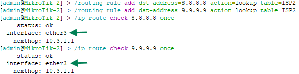

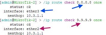

For all those routes, as the exit gateway, there is a 50%-50% chance that the connections go out of WAN1 (ether2 in the screenshot) or WAN2 (ether3 in the screenshot). And the distribution (which depends only on the source addresses and destination addresses of the packets) are the same regardless of the routing table chosen. Your mark-connection and mark-routing mangle rules are useless.
In the following screenshot you can see the exit gateway depends on the destination address (different src-address/dst-address pairs produce different ECMP hashes):

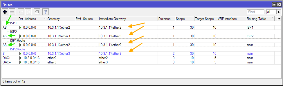

If you specify the interface (as %WAN1 or %WAN2) in the gateway as @rplant suggested above, then you avoid this ECMP situation:

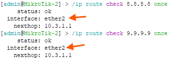

The routes will have the expected exit gateways and no longer have the ECMP (+ sign) flag. And now the same exit gateway is used for all destinations (active route in the main table)
Forcing the route to the ISP2 table also results in the correct exit gateway to be used:

To make it works, OP has to make sure that the ISP2 and ISP1 tables have different immediate gateways (and the matching exit interface) for the default route, which is the case in my 3rd screenshot above.
