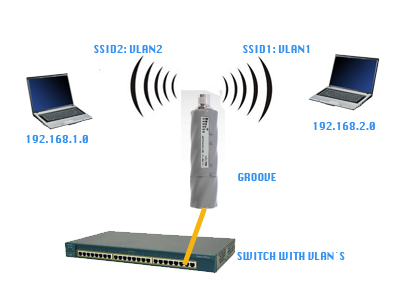

Hello, first of all, sorry for my bad English.
I have a RB-Groove A-2HN, but I have problems.
My goal was that the AP had two SSID’s, (virtualAP’s), each associated with a different VLAN, then according to a pc be connected ssid, would have access to a network or to another.
I created the vlan’s, I created the bridge, I created the VirtualAP, but I connect with the PC and I have ssid ping the network.
Any help please?
