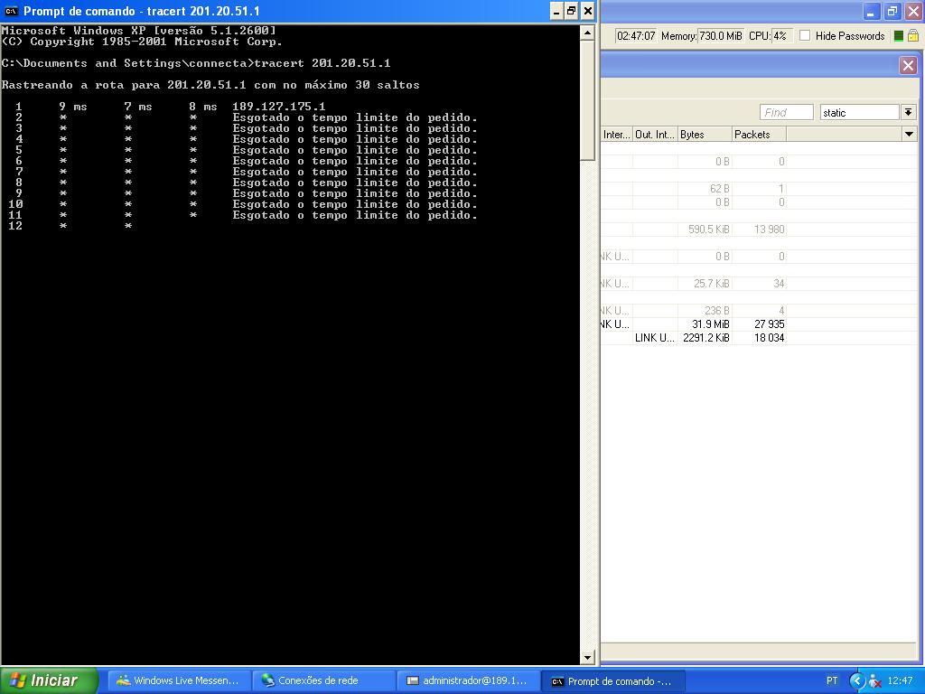

Using the traceroute command I get only the ip of my mikrotik and nothing else.
Please if you can tell if the configurations up there are right.

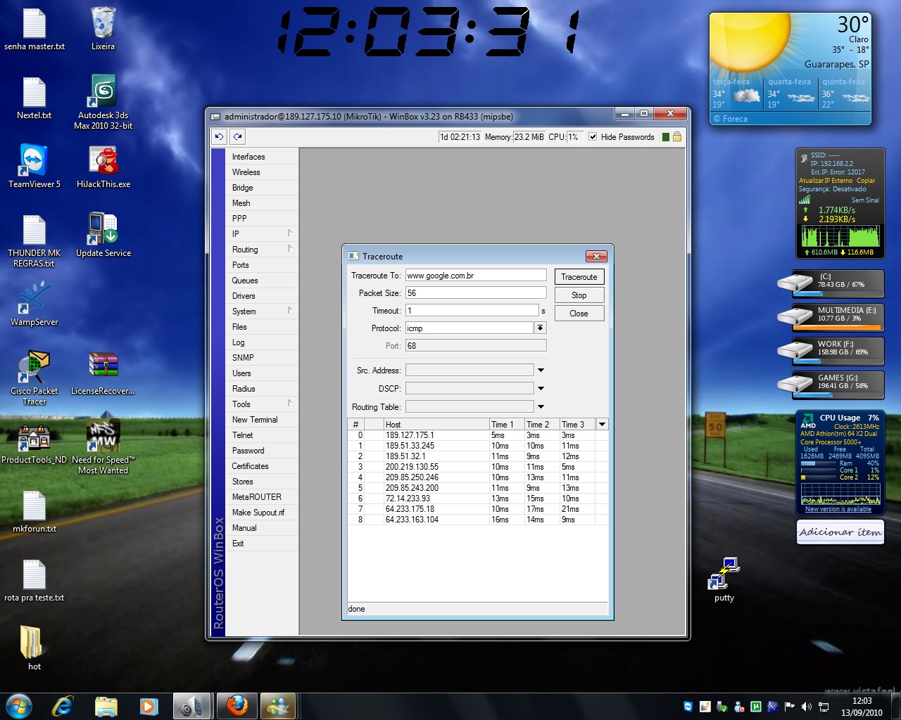

Hello my friends, problem solved here.
After much argument with the operator, they decided to mess around with configurations of them and began to function correctly on valid ips customers.
I appreciate everyone’s help.
