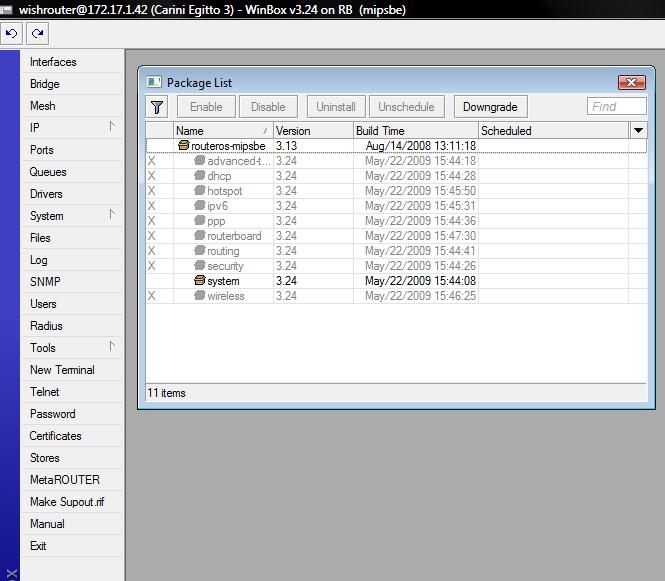

I already tried to do so and I get this output:
What is this? 3.24? 3.13? 3.18,5 ?
How can I downgrade to 3.13 ?
I cannot think that it is not possible to downgrade a new software to an old one. Could you please help me ?

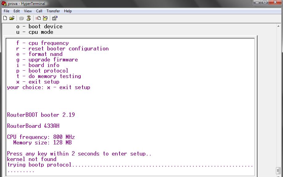

It’s one day that I’m trying to make the downgrade by netinstall, putting the sofware, formating the nand, putting the bootloader and again the software without any success.
Now the board tell me that kernel was not found.

After putting 3.13 with netistall the result was: kernel not found and the board never went up.
After putting 3.24 with netinstall the board went up soon.
So, probably what you don’t want to say is that with new software you changed the file system and so it is not possible to make a downgrade to the 3.13 software just because it used a different file system.

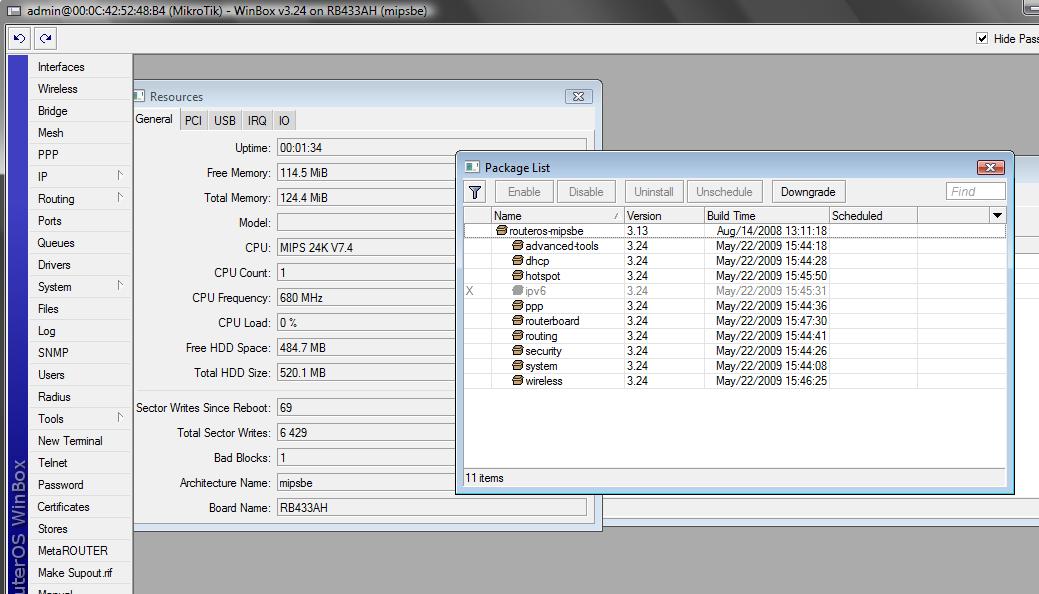

As suggested I took my RB433AH and I changed the CPU frequency from 800Mhz back to 680Mhz ftp-ing the file and pushing the downgrade button.
The result was the following:
I restore 3.24 software and I tried to make the downgrade (with CPU at 680Mhz) by netinstall and I get again: “Kernel not found”.

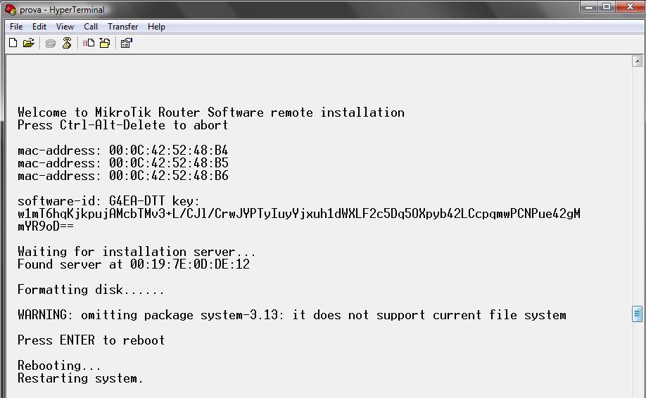

So I put again the 3.24 software on, to have the board working again, and I tried to put every single package of 3.13 by netinstall getting:
Was it changed the file system with new software, as the board said ?
