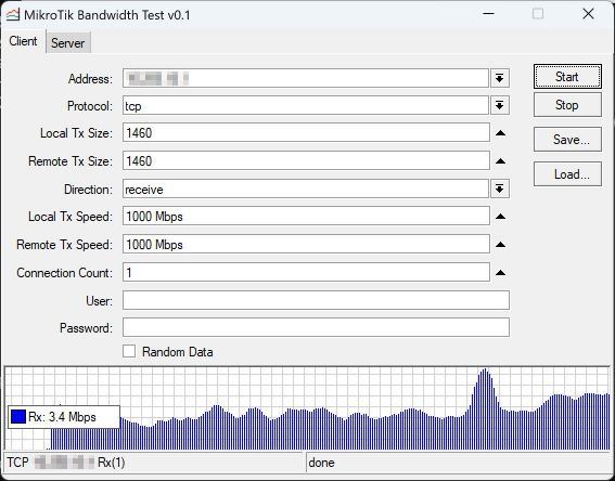

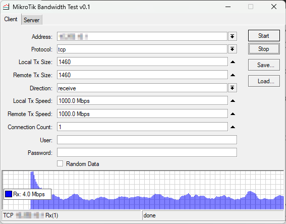

I also ran a couple of tests using BTest as well (TCP, receive):
  1. From Location A to Mikrotik directly:
  2. From Location A to Mikrotik via WireGuard VPN on Mikrotik:
  3. From Location A to Mikrotik via L2TP/IPSec VPN on Mikrotik:
Here the download speed is higher directly than through VPN and is higher than when downloading from NAS.
