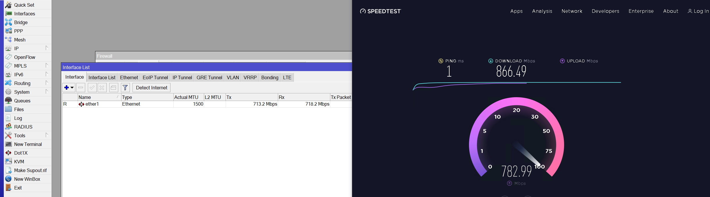

I’m passing a few VMs(Windows) traffic through a Mikrotik, on interface, the upload traffic is showing correctly when I upload something through VMs, but when I download, it does not show the actual traffic.

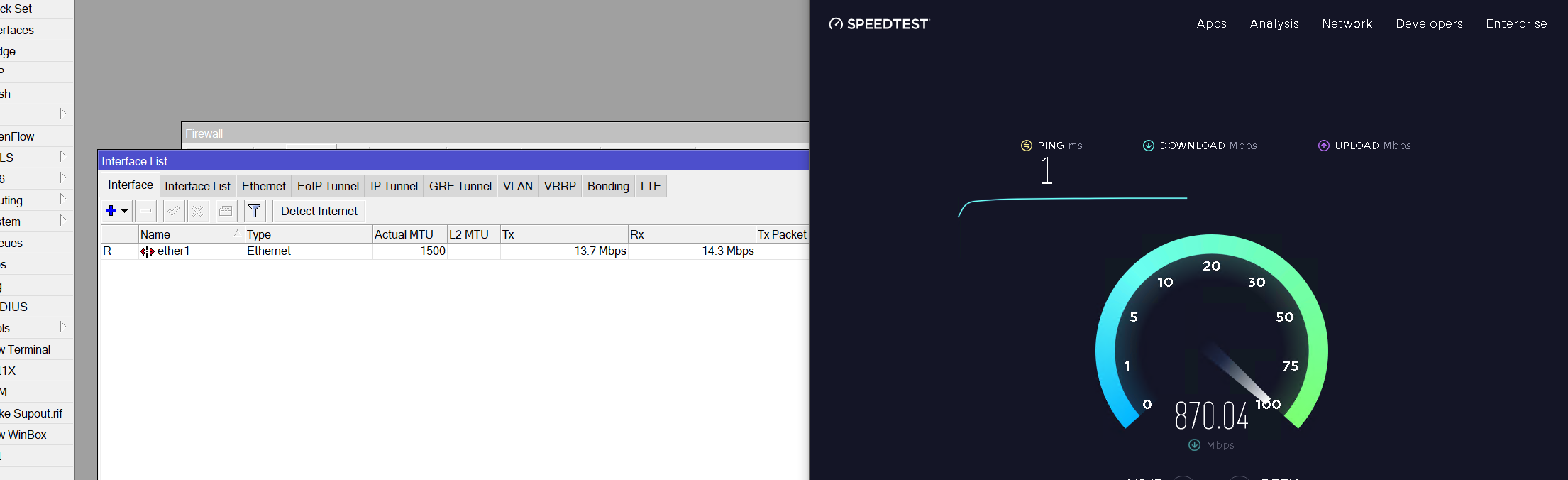

For example, I’m downloading with 400Mbps on VM, but it shows like 10Mbps on Mikrotik Interface!
Any idea what is happening there?
Update:::
I have attached the results.
Also, I wonder Why Rx and Tx increase to the same range when I just download or upload at the same time!!! both show same amount!
From what I see on your screenshot you only have a single interface (and the filter button does not seem to be enabled). Is that correct ? If that’s the case and if you’re using your device as a router which ony has a single port connected (and does intervlan routing for instance) this may explain the situation: traffic comes in from ether1 on vlanA is routed to vlanB and goes out through ether1 as well. As a result you would observe then 2x ~718Mbps on a full duplex link.
As for the 2nd result (download) we could guess various reasons. But the best would be to have some more information about your network topology and the config file of your device (is it a device or a VM with RouterOS ?).
